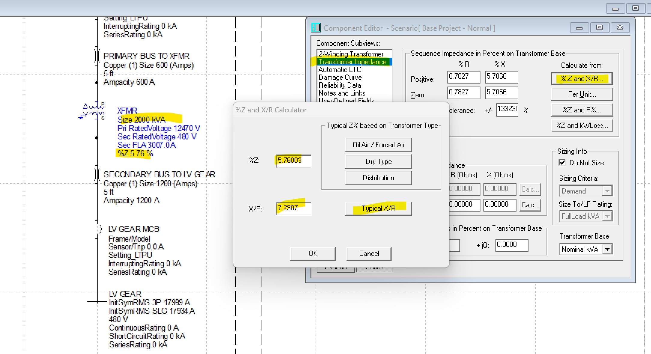

Looking at an old arc flash study done for a project I'm working on, I notice they derived the X/R ratio for the utility transformers:
"An X/R ratio of 7.29092 was used to model the 2000 kVA utility service
transformer designated UTIL XFMR MAIN BLDG obtained from IEEE Std.
C37.010-1999. The transformer nameplate impedance is 5.76%."
So I notice C37.01-1999 is not a free-to-access document. Anyone know about these formulae? Not trying to get something for free that we should be paying for...is this something any of you have used? The formulas or the document?

I'm not familiar with that IEEE document nor am I sure what your voltages are or if it matters but I used the %Z and X/R function on SKM and clicked on Typical X/R and got the same exact value as in your old study. My assumption here is that SKM may be using whatever is in that IEEE doc for this function.

The good news is a transformer X/R ratio is usually not a deal breaker. It can be determined with transformer test reports which I assume you don't have (you would be in a large minority if you did) so here is a bit of additional information.
IEEE C57 (Transformers) standards list "typical" X/R ratios and ranges of impedances for transformers.
Do NOT us a typical impedance as this has a direct impact on the short circuit current. This should be from the name plate.
However, "typical" X/R ratios are generally OK and software often defaults to these values as bbaumer points out.
The X/R ratio is used for the math. It is the tangent of the impedance angle of the transformer which is used to add impedances vectorially (including affect of angles) Whether the X/R is 6 (80.5 degrees), 7 (81.9 degrees), 8 (82.9 degrees) etc. should have a minimal impact on the results. Of course, it's better to use values that provide conservative answers but again, it shouldn't vary all that much.
