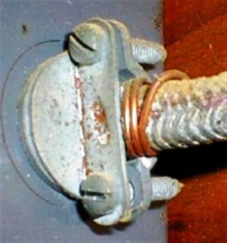

 Post subject: WE CALLED THIS THE "BOSTON BACK WRAP"
PostPosted: Sat Feb 23, 2019 5:37 am
This method was used to provide for a termination of the equipment grounding conductor in this type of cable assembly.
Sure its wrong. how did your area call this out? :cry:
File comment: Boston Back Wrap?

Please tell me about this reply and how it helped you. It is not a recognized method.
