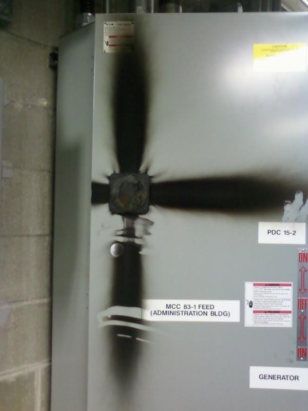

We had a event a few weeks ago. Electricians were working in a control compartment when a fuse blew, and almost immediately afterward the breaker next to them blew. No one was injured. The breaker compartment had the door closed, and the calculated arc energy was nearly 50 cal/cm2 at 24". Although the door stayed shut, the electricians did report seeing fire shoot out from around the door for a distance of 12" - 18". (As they were moving rapidly in the other direction...!) From the damage that was caused, I don't think that they got the full 50 cal effect. If so, they probably could have been burned even working in the other compartment. This was also on some older switchgear, and the door was very strong and well latched.
PostPosted: Mon Oct 12, 2009 1:42 pm
Closed doors, good solidly built ABB metal clad gear.
PostPosted: Mon Oct 12, 2009 1:44 pm
Closed door, 13.8kV switch, only HRC 2 per the tables with doors closed.
I can do this all day, I see this stuff everyday. I don;t care who intreprets what how, or if a FPN is enforceable or not, unless it is arc rated, switchgear can not be relied on to contain an arc flash.
