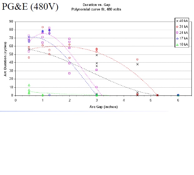

PostPosted: Fri Mar 25, 2011 5:03 am
A 120V residential panel is "not likely" either, but here is one that was.
PostPosted: Fri Mar 25, 2011 5:07 am
JBD wrote:
I have continuously stated my discussion is about the routine on-off operation not resetting of a circuit breaker rated/listed/tested to be used as a switch.
I don't think I ever said you did not say that. So, as far as labels, do you put different HRC's on your labels for "normal operation" and "reseting"? If the calulated Ei is a HRC 3 like in the OP what method do you use to determine the HRC for "normal operation"?

The definition says it is "not likely to pose an arc flash hazard". It does not say that an arc flash will not happen. In my opinion, that means that there is a potential for an arc flash to occur.
Today the lottery is over $300 million, are you going to buy a ticket because you are likely to win? There is always a chance that a vehicle will run a red light, do you never cross a street because you are likely to get hit?
The code was written using the modifier 'not likely', maybe they should have used 'not probable' or 'not possible'?
