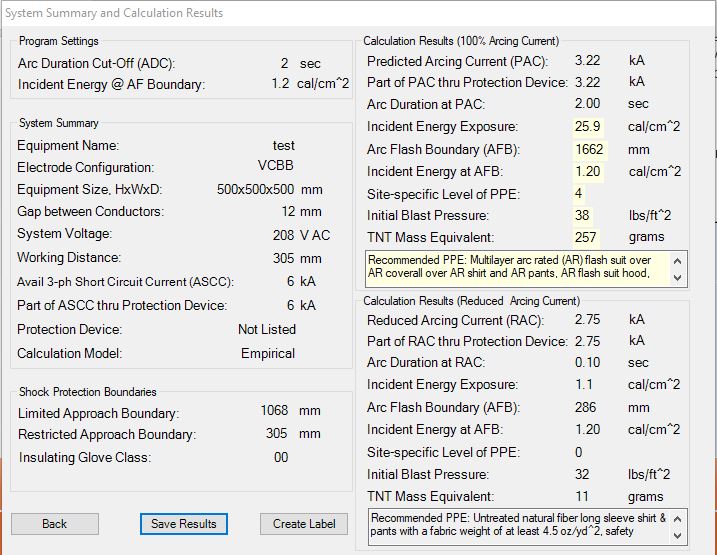

PaulEngr, and others,
75,000/240/0.02=15625 amp
kVa = 75,000
voltage =240v
Input the same data.
Why is it much lower?
Where:
parallel runs)
of circuit.
E = Voltage of circuit.
Then you get M = 1 / (1+f)

PhilEngr, any ideas?

Posts: 45
Table 65: at 1000 feet
Resistance is 0.129 ohm
Reactance is 0.0342
Z is impedance
1.732 is just sqrt (3)
1. arc flash added impedance
Posts: 45
Let's compute:
Reactance is 0.0342
For 1 foot:
entering the above data,
f is 0.347,
M = 0.742
Isc (bolted scc) = 11597 amp
20 feet awg 1 impedance
For 20 foot:
240v/0.01625 = 14769 amp.

Posts: 45
Here's it's more intuitive.
Posts: 45
Identical results to:
Posts: 45
= 0.0053383ohm
That is
given I(trans)sc of 15625A,
Posts: 45
Isc (transformer Isc) = 6971A
Posts: 45
