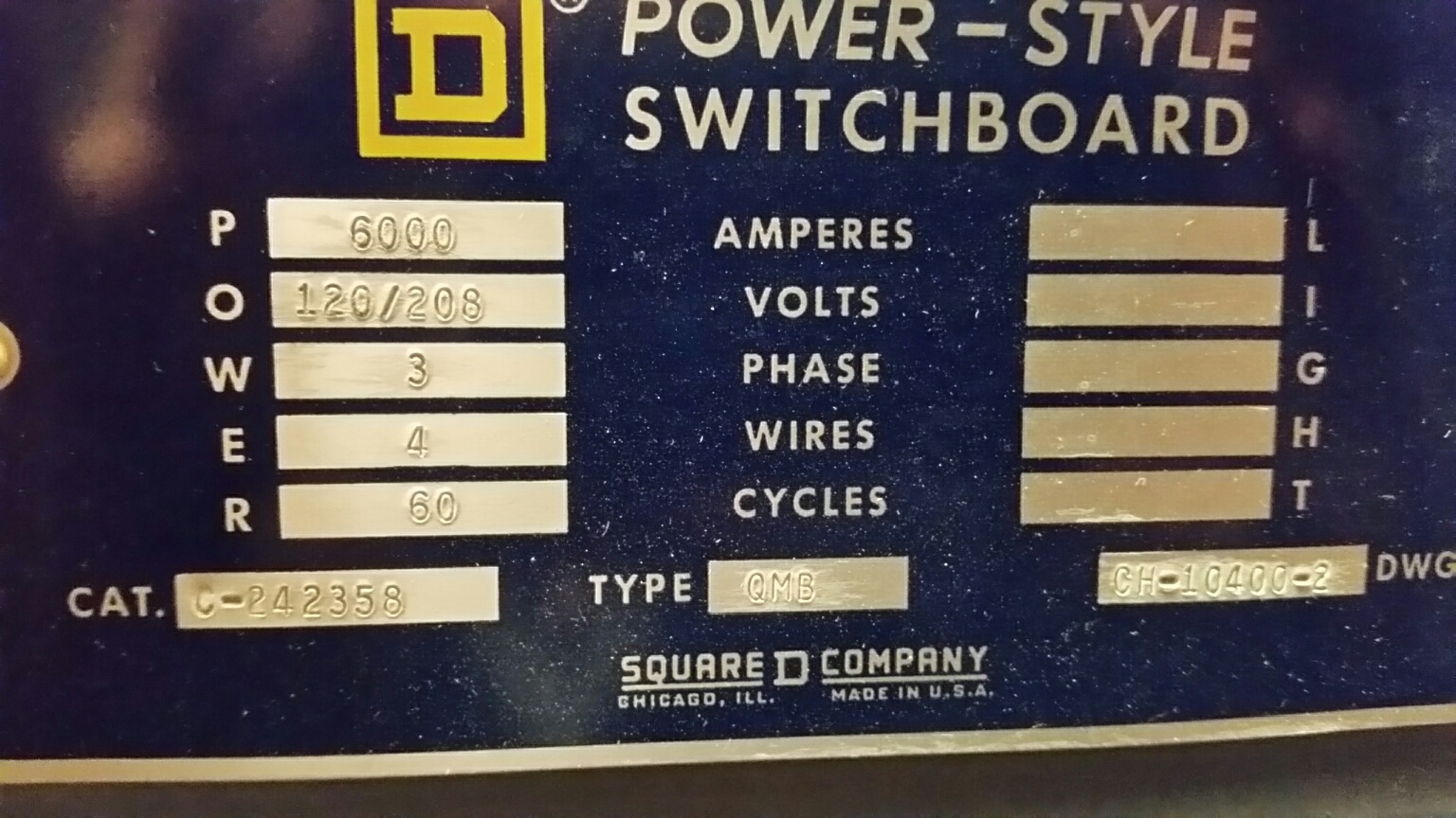

We have a panel that is listed a HRC3. As I am planning a small job for this panel I notice a good portion of the breakers are the ones pictured. Obviously they have a 10k rating. Is it possible to have an HRC3 panel with 10k breakers installed and everything be fine? Thanks for the input.

It is possible because time to clear is the biggest factor in the IE equation. So you may be under 10K fault, but taking seconds to clear and generating a large IE. You need to find out your RMS sysmetrical fault value to know if 10K breakers are sufficient.

The HRC3 applies to the incoming line and not the load side of the smaller CBs.

If one of those 60A CBs blows-up while you're operating it, the maximum IE is related to the availble energy at the line-side, in-coming side, of the breaker panel.

I think you are confusing fault current, AIC, and Ei. The difference between the line and load side of that breaker is not current, it is the duration an arc would be present based on the clearing time of the upstream breaker for the line side and the clearing time of that breaker for the load side.

Ok so I got some sleep and I think I now understand. You could only have say 8k of available fault current but because the device up stream and long conductors cause the fault current duration to be to long you then end up in a higher HRC.

Yes. You are mixing up several distinct and seperate electrical parameters.
Fault current has many components but the simplest to understand is the bolted fault. Imangine someone took a copper buss and bolted it across all three phases where the incoming cables enter the panel. Then they turned on the power. V=IR, and because the voltage is constant, and R is near zero, I will be very high. If we looked at the steady state value of I, we will call that Fault Current RMS symetrical. The breakers in the panel need to have an AIC rating equal or greater to this value.
What is AIC do for you? Remember in high school the right hand rule of thumb for magnetizm - you put your thumb in the direction of current flow and your fingers wrap in the direction of the magnetic field. Only in AC power, the current direction is changing 120 times per second (there is one up and one down direction in each sinewave). With high current you get strong magnetic fields. These fields are inside the breaker, and they are pushing and pulling the seperate phase components to and from each other. If that 'push' or even the continuous working of those components causes them to break, or to pull fasteners out that hold them in place, they could touch each other. If they touch, its a short circuit and the high current melts the metals and the gases released caused the breaker to exploded. What the AIC rating does is test the breaker to make sure it can withstand that intensity of a magnetic field, without the components breaking and without the breaker exploding.
IE is the measure of heat intensity due to an arc, where something crosses phased conductors and causes that melting of components and the rapid release of gas. We won't call that an 'explosion' because it melting and gas generation take place in open air. There is no enclosing device to break and give way under the blast pressure. To arrive at a value for IE, fault current is one of the variables in the equation, but its only one, there are many more such as the spacing between the component phases, the distance your chest is from the blast point, whether the blast is in a box or open air, and one of the most important - the time it takes for upstream overcurrent devices to open and clear the arc. Time to clear, has the greatest effect of all the values. So even if you have low fault currents, you could have high IE values because the time to clear is very long.
As to operating the breaker, you are off track here depending on what you are doing. The HRC level on the sticker is for performing live work, that means you are removing the covers and working inside the panel while it is energized. If you are just operating the breaker dead front, meaning the covers are on and you can not see any live parts inside the panel - then you don't need any HRC or at least much less than the label. Why both, because 70E is about working on live parts, switching breakers with cover on is not live work. 70E doesn't apply to non-live work except for large energy switching like switchgear. NFPA generates confusing in that if you follow their table matrix for what HRC you need versus function, they call out HRC 0 for operating breakers with covers on. NFPA does not explain the discrepancy. My personal assumption, is that the HRC is only meant for people who operate breakers and 'also' perform live work like electricians. Having just installed a new breaker and button up the covers, there is a higher risk when the breaker is thrown on for the first time. Others will disagree.
