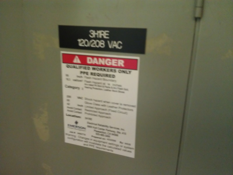

I work in a tier 3 data center and we are having an Arc Flash study done. I have the job of checking out the results. The engineers that are doing the study have done a few more calculations than I have seen in other studies. The question that I have concerns our RDC's (remote distribution cab.). The RDC's have 4 panels, 2 in the front and 2 in the rear. The engineers did separate calculations for the front and the rear with a class 3 assigned to each side. They also did calculations for the 4 individual panels that were assigned a class 0. The RDC's are fed with a 225 amp breaker from our PDU's. The PDU's have a transformer (480 to 208 volts). The feeder terminates on the bottom of a contact block in the RDC. The contact block has two sets of feeders coming off the top to feed 225 amp main breakers at the 2 individual panels on each side. The panels have a small 3" X 8" opening at the top where the feeders terminate. The main breakers are just above this opening. With the feeders from each panel paralleled to the top of the contact block, would OSHA consider the tecnician to be exposed to the class 3 energy through the opening at the top? From a practical stand point, the opening is at the 5 foot level and if the tech was working on a lower section I don't believe the flash would reach him. I have attched pictures to show this application. I would appreciate any comments as I believe opinions might differ.
Thanks!

Typically, most studies will ignore the breaker inside the panel for providing any protection for an arc flash and rely on the upstream breaker. The reasoning is that the arc flash could engulf the panel main breaker rendering it useless.
But what I am interested in is why is the RDC a Category 3 hazard. From your description it sounds like the RDC is 208V fed from a transformer in the PDU (Power Distribution Unit??). I would suspect that this 480-208V transformer is probably less than 150 kVA (most likely 50 or 75 kVA). If this meets the Exception #1 in Article 130.3, then it could be considered Category #0. also are they using a 2 second cutoff limit on the arcing time?

Our PDU's are 225 KVA with 350 amp mains. The results table shows the RDC's trip time at 2 sec., a breaker opening time of 0 and incident energy of 20 with an (N3) listing. The engineers are using the SKM summary view option which lists the last breaker to clear the 80% fault threshold. They show the main breaker, at the PDU, feeding the RDC as the protective device. The individual panel calculations that show a class 0 have a .032 sec trip time, a breaker opening time of 0 and incident energy of .033 with an (N3) listing. As to the original question about worker exposure, the research I have done has been inconclusive. We have fashioned protective barriers for the area that I am concerned about but these are primarily for shock protection and to keep the tech from shorting anything out. As far as the RDC's are concerned we de-energize them at the PDU's to add or delete circuits but we can't do that to take amp readings. When working on a PDU, which has a similar opening, we turn off the main to the distribution panel but not the transformer main as this causes problems from the start up surge. Some of the information that I have researched considers that electrical equipment can at any time just self-destruct.

RDC's / PDU's typically are installed with K Rated transformers. These end up having low impedances ~2.5-3.5%Z. This results in decent fault current levels on the 208V side, with everything usually requiring the 22K rating.
When you couple this with robust upstream distribution for fault coordination, the CAT 3 incident energies are common.
