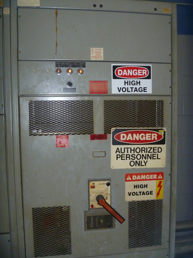

The Navy is actually how I got started in this arc flash stuff, we were installing arc flash devices in our switchgear back in the early 90's. Similar to the light sensing relays that are becoming more common in the civillian world today. My sub was one of the first to install that system.

I'm a electrical officer with the Canadian government and have been tasked with Arc Flash with our fleet. I'm glad that there is mention of vessels in this form. Usually in our vessels, there is operational breakers in the vessel's control room as close as 2 feet from your back, these breakers are in a switchboard, (there is a thin steel metal door or cover) operation of the breaker can be independant of operating personnel automatic (opening or closing). Reading different articles, my conclusion would be adding some protective sensing device to each breaker, photo,heat etc. open the breaker sooner, lessen the fault time.
Please if anyone has thoughts on this I would appreciate it. Also is there a template for an arc flash analysis study, that can be presented to a contractor ?
Thanks in advance.

Under normal operating conditions, the breaker opening time often has to be delayed to give downstream devices time to interrupt a fault. "Maintenance switches" can sometimes be added to reduce arcing time while maintenance is being performed on downstream equipment. This would not reduce the arc hazard that might occur if the breaker itself failed. To do this would require reducing the clearing time of the device upstream from the breaker.

I was wondering how did the sub's get a solution to there arc flash issues. Were other electrical sensing devices added to their systems to monitor for arc flash, light or temperature. And correct me if I'm wrong, there isn't a concern if the doors/covers are kept shut, while the system is in operation. Meaning if you are just walking by (not opening doors) ,there is minimal danger, and no PPE is required.

The control room environment you describe is not unlike some tanker ship work we have been involved with. In some configurations the Flash Hazard Boundary will extend to the limits of the control room. In our work there was an option to reduced arc flash hazard by configuring the switchboard to operate through a arc flash limiting tie breaker and that was our recommendation for any time the breakers needed to be worked on.

Sorry if this is elemetary but just curious what the effects of the short circuit and ultimately incident energy levels are on this type of system. I would assume that they are very similar to a generator system used for emergency or backup. How does this system ground is it a floating ground at the generator? What types of tripping times does this system see and are the energy levels higher? Like I said truly just curious would appreciate the education.

Nothing really different from systems on land, except that my experience includes exceptionally well coordinated systems because the entire ship's distribution system is procured at one time from one vendor.
