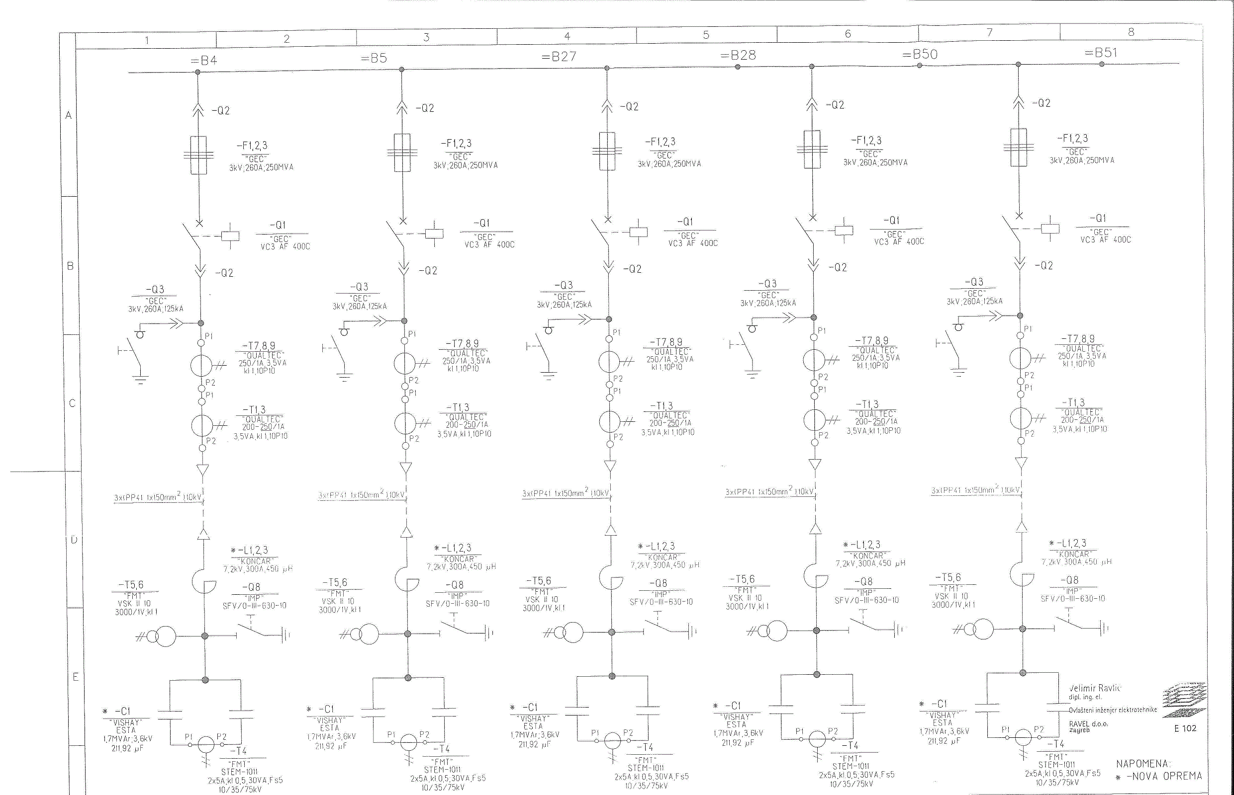

I have a Fire Pump Controller that is directly tapped of the main transformer (1500kVA, 12.47kV-480Y/277V) and as one would expect the arc flash hazard is 63 cal/cm2. This makes is impossible to do any work inside the controller as the circuit breaker is inside the controller. I suspect this may cause some issues in testing and maintaining the fire pump controller and fire suppression system.
I am sure other people have experienced this situation and would appreciate any insight on how you handled it.

You are right. If there is no OCPD ahead of the Fire Pump Controller there is not much you can do.
However, many times, when I consider the utility overcurrent protection at the primary of the utility transformer, the AFIE is reduced to levels below 40 cal/cm^2. Other times it doesn't. The only way to be sure is to perform the calculations.
So call the utility, get that information, run the arc flash study and see if the AFIE has been reduced.

Thank you. The results shown are with the utility fuses taken into account. The system setup is 100K fuse links, 700ft of utility cable, 1500kVA pad (12.47kV - 480Y/277V).
Even though it is not entirely my issue, I am concerned on how fire pump testing is done. From talking with an electrician he said motor currents are verified by clamp on readings taken from the motor leads inside the fire pump controller cabinet. Obviously this can't be continued and will probably have to be done in the motor peckerhead. I do not know what other readings need to be done in the fire pump controller for annual testing and certification.
I was thinking that a fused disconnect could be installed upstream but have not researched the code on that.

What you will find on fire pump controllers is that they are designed and installed so the motor will melt down before you clear a fault from an OCPD. The OCPD must carry locked rotor current indefinitely.
Have you considered mounting CTs in the controller cabinet and an external meter?

Why not install an Arc Flash Reduction Maintenance Selector switch on a protective device that could be switched in and out of the circuit that would reduce the AFIE to a manageable level just for the time required to do the maintenance? Even 3 phase make-before break transfer switch(es) could be used to cut a fused disconnect switch in and out. The permanently installed CT's/Ammeter (on the outside of the controller) sound like a really great idea as well, preventing opening the enclosure to expose live parts just to take a clamp-on ammeter reading. We add remote monitoring of the ARMS switch just in case the technicians forget to switch it back to normal. We also sometimes add clear lexan covers over sections of panels with V > 50 Vac along with finger-safe fuse covers, etc.
You could entertain the installation of cable limiters, reactors, or replace the transformer with a higher impedance unit to limit the fault current. These options may not be feasible from a cost standpoint, but NEC Art. 695.4(B) (Fire Pump Controllers; from the Handbook) "...permits, but does not require, the installation of a disconnecting means and associated overcurrent protection between a power source and the fire pump control devices described in [color=#ff0000][color=#ff0000]695.4[/color][/color](B)(1). Other requirements in the Code such as [color=#ff0000][color=#ff0000]230.70 [/color][/color]and [color=#ff0000][color=#ff0000]225.31 [/color][/color]may necessitate the installation of the disconnecting means and overcurrent protection covered in the requirements of [color=#ff0000][color=#ff0000]695.4[/color][/color](B). Ideal, but not always possible, would be the direct connection of the source to the fire pump control equipment in accordance with [color=#ff0000][color=#ff0000]695.4[/color][/color](A)."
Many options...
Does your application not require multiple sources that may be required by NEC 695?
