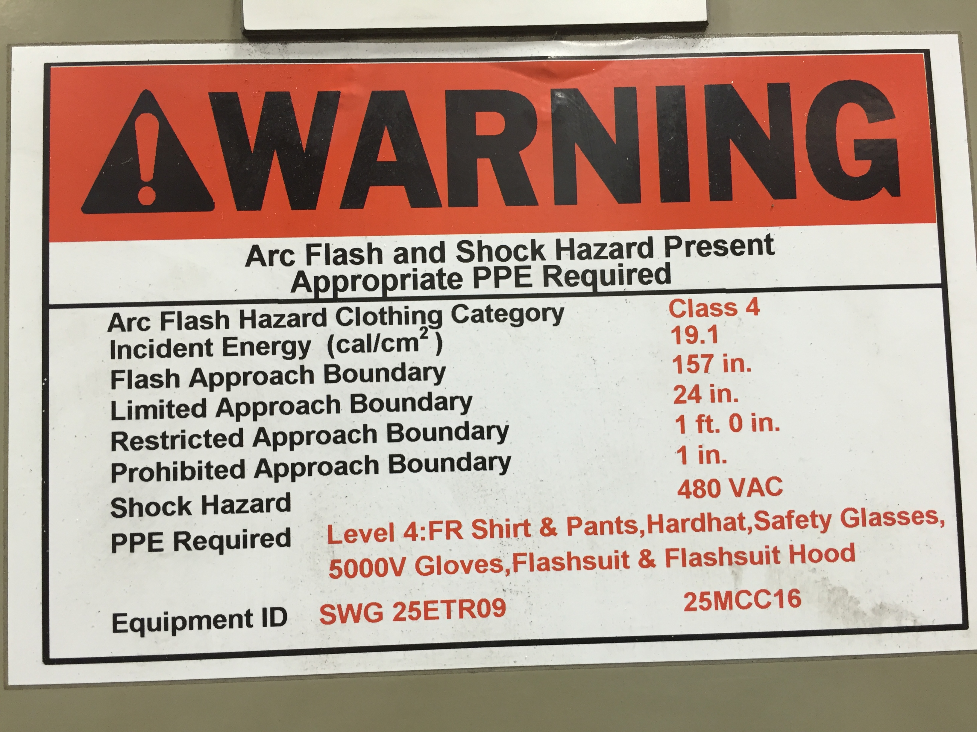

Okay, more information about my facility. I started working here last fall. I was finally able to obtain both the SKM model performed by the engineering firm associated with the mill and a copy of Power*Tools within the last month. Yesterday I received a label printer so I am able to print updated labels myself.
My plan is to extend the model (which is pretty much at the MV level) down to the 480 level and relabel everything. I'm also concerned they didn't include enough scenarios in the arc flash model given we have four turbine generators and a utility feed for the mill. I will be studying that to see what the potential impact on the arc flash modeling is.
Anyway, what I have found in use in the field are two labels.
One of them is fairly typical of what you would find in the recent past. It includes
"Arc Flash hazard Clothing Category" (which directly follows the tables)
Incident Energy
Flash Approach Boundary
Limited Approach Boundary
Restricted Approach Boundary
Prohibited Approach Boundary
Shock Hazard (voltage present)
PPE Required
Equipment ID
So I'm not too worried about that label. The label I update with will remove the clothing category, prohibited approach boundary and PPE required.

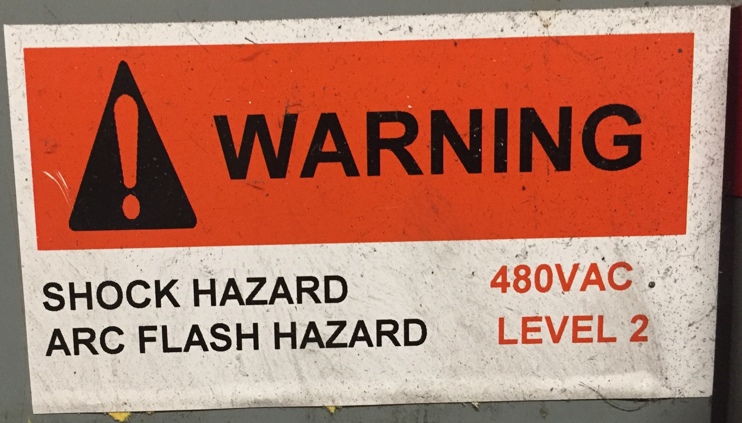

The other label I found has the following:
Shock Hazard (in VAC)
Arc Flash Hazard (As a Level, corresponding to the tables)
And that is it, just those two data points. I'm just trying to come up with a general rule to give to people to deal with these labels until I can replace them with proper labels. The guidance I have decided on is to tell people to assume a boundary of ten feet for Level 2 and forty feet for Level 4.
And I will try to work in updating these labels as quickly as possible.

File comment: Existing "70E" label.
File comment: Existing label with too little information.
