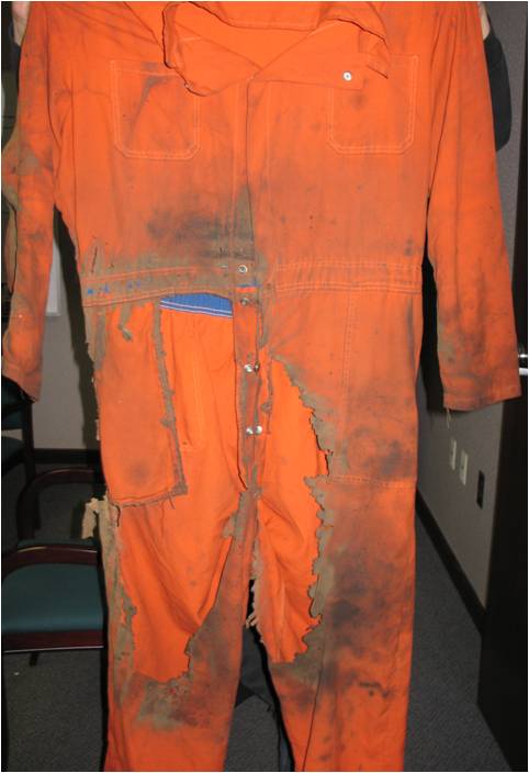

PostPosted: Mon Mar 16, 2009 11:36 am
Jnox wrote:
I should probably rewrite the question. Essentially, what I'd like to know is, when you just want to peek inside the cubicle, do you need PPE on?
Most of the MV/HV switchgear, when you open it up, there is no LIVE parts directly exposed. It is all in the back of the switchgear. I have been asked, if this is the case, why need for PPE since you will not work on any live parts?
No exposed live parts here either, would you have wanted to be in front of this switch?
There looks to have been exposed energized parts in that switch and we do not know what triggered the event.
In general we do not require arc flash ppe to look inside switchgear, providing it is a 'look' and not 'touch' and there is nothing that might disturb the electrical field. That is 'in general' but there are also conditions such as excess spider webs, rusty or loose switchgear componentes where merely opening the door might constitute disturbing the electrical field.
