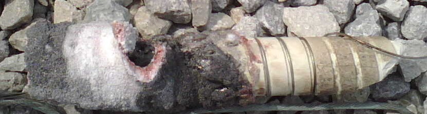

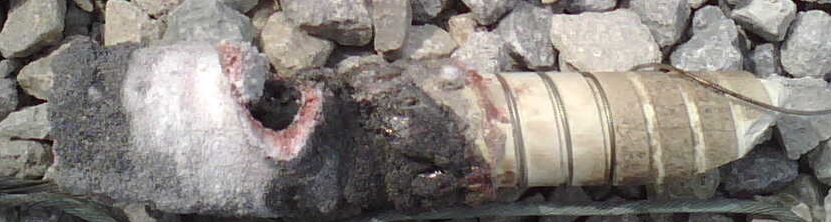

The metal elements do degrade under load through successive thermal cycles such that they effectively thin out and "trip low" as PaulEngr suggested. But this is from duty under load, not sitting on a shelf.
Similarly, fuse connectors degrade under load and load cycling in the same way all connectors do, and may overheat to the point that the fuse catches fire just from high contact resistance, the same way some individuals in a population of similar connectors (by current class) would be expected to overheat after long duty. Again, this does not happen on a shelf.
The insulating materials of fuses, though, degrade on their own, and more so with exposure to the environment. Composite materials become brittle, particularly with exposure to heat and UV. I've seen outdoor mounted fibreglass fuses that have suffered so much epoxy degradation that the glass strands are sticking out and they look like they need a haircut. In this condition, the fuse housing is unlikely to withstand a fault and could explode when called upon to operate. If this is a current limiting fuse, the sand would be expelled and the current would no longer be limited and the fuse may not interrupt at all. Example in photo attached.
