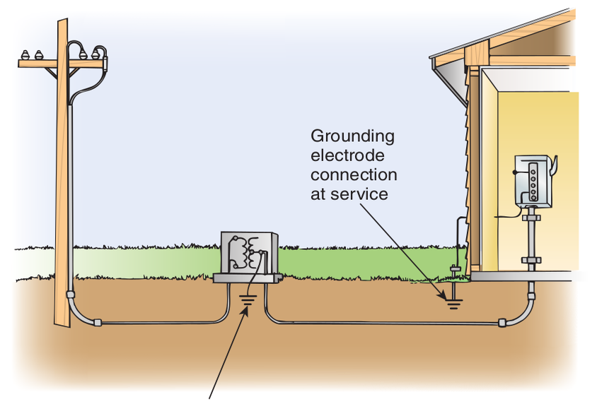

This is an Electrical Grounding questions (NFPA 70 2017) that affects the arc flash calculation.
I have a customer that states that the following installation is NOT grounded and therefore I should not consider the Grounded option in the calculation of the arc flash incident energy.
I have an OUTOOR Delta-Wye transformer feeding a building.
The neutral terminal at the secondary is connected to the metallic frame of the transformer through a copper conductor and using a good connector at the frame.
There is another connector attached to the frame. An uninsulated copper conductor is connected to the frame and to a grounding electrode in close proximity of the transformer.
Therefore, the neutral terminal is indirectly connected to the grounding electrode.
In other words, the neutral terminal it is not directly connected to the grounding electrode through a continuous "grounding electrode conductor".
Question:  Is this installation satisfying the NEC Article 250 requirements? If it is, I should consider the grounded option in the arc flash equations.
Just to clarify this question.
This installation is in an OUTDOOR transformer.
The installation requirements of the "grounding electrode conductor" that are specified for the service equipment do not apply to this outdoor location.
Thanks.

First. It does matter that is an outdoor transformer because the NEC has a specific article for outdoor transformers. See NEC 2017 Article 250.24 (A) (2). Here it states you have to have an additional connection to earth in case the transformer is outdoors. If this transformer is indoors, it would NOT require an additional connection to earth. Additional because there is already a connection to earth in the service equipment. By the way, this is the service transformer, not a transformer that provides a separately derived system.
Second. You mentioned that because the transformer (neutral terminal) is bonded (to the frame of the transformer) and then this bonding is grounded, it is wrong according to the NEC. I do not agree. Please refer a specific article that applies to thus specific case that stipulates that this is not allowed.
Third. You argue that the connection to earth at the transformer will have a resistance higher than with a copper conductor because the current is flowing through steel. This is also debatable, because the large area of the steel of the frame of the transformer will probably reduce the resistance to a value lower than the small area of the copper conductor.
Fourth. As a reference. The NEC 2017 in Article 250.24 (A) (4) allows the grounding electrode conductor to be connected to the frame of the service equipment (i.e. the ground bar) instead to be connected directly to the neutral bar ot terminal of the service equipment. So, you have the grounded conductor from the outdoor transformer terminating on the neutral bar of the service equipment, then a main bonding jumper to the frame (i.e. the ground bar at the service equipment) and then the grounding electrode conductor connects to this ground bar in one side and in the other to the grounding electrode. This set up in the service equipment is exactly as the one I am referring on my original setup in the outdoor transformer. If it is acceptable for the NEC in the service equipment, I assume it is also acceptable for the additional grounding connection at the outdoor transformer.
I would like to hear any comments regarding if the grounding connection at the outdoor transformer satisfies the NEC requirements or not, but please refer to the NEC specific articles in your answers. If it does, I can use the grounded parameter in the IEEE equations for AFIE.
Thanks.
It really just says that it is connected to your service entrance bonding. The illustration from the 2014 Handbook attached shows a ground electrode jumper tied to a conduit and the conduit is tied to the transformer neutral so yeah....you could do almost anything you want to with this particular ground.

You didn't differentiate whether the transformer was a utility or a owner transformer in a campus type set up or simply a separately derived system fed from another building.
The short answer to your question is: Per NEC 250.20(B) your system is required to be a grounded system.
Service Transformers & Campus Type Setup: At the outdoor service transformer, there typically is a bonding jumper from the X0 lug to the case and a grounding electrode conductor (GEC) from the case to an electrode. However, from the transformer to the meter or service disconnect, all you run is ABCN with no grounding conductor. At the meter or service disconnect you are required to have a main N-G bonding jumper per NEC 250.24. At that point, you're required to also have a GEC to a grounding electrode.
Separately Derived System fed from another building: Follow NEC 250.32(B)(2). The System Bonding Jumper may be at the transformer or the first downstream overcurrent protective device/disconnect. Where the system bonding jumper is determines where the GEC to the grounding electrode goes.

Yes, it is a service transformer.
Thanks for your response. I confirmed that this installation meets NEC requirements for grounding outdoor transformer with an NFPA expert. Thanks.
