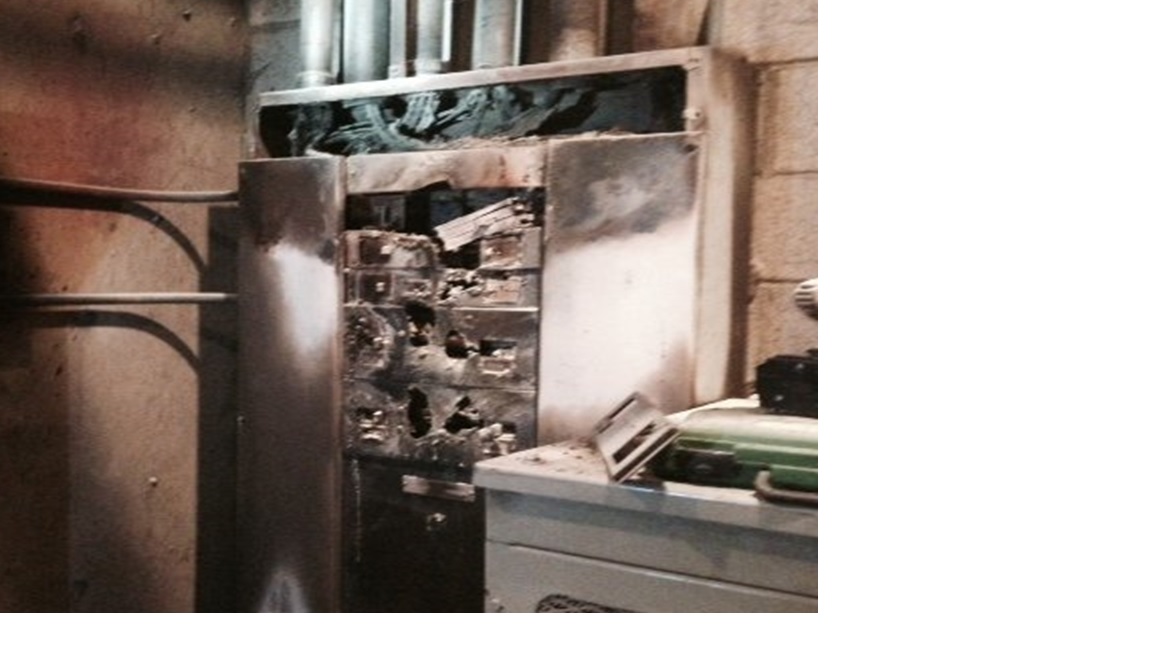

In 2012 or 13, an incident occurred in the main electric room of a retirement home on the Pacific Coast. The attached incident photo shows a 208V 3Ph 4W 400A panel, fed by a 300A CB that sustained an arc that didn't extinguish primarily due to the condition of the breaker. The maintenance history is a common issue: No original testing and no subsequent testing or maintenance.
The facility manager wouldn't allow it to be shut down as it would be "inconvenient" to the residents. The contractor acquiesced and then this happened (the breaker seen leaning in the upper tight corner was the fault locus). It is likely that it was never torqued properly, when installed, and as I previously said was never shut down for maintenance.
The result was a lot of equipment damage, but due to the direction most of the arc energy took (up), the injuries were relatively minor (it did trigger a Cal/OSHA investigation). By the way, both the people involved in this weigh in at 260lb +. Both were knocked off their feet. The arc was stopped by manually shutting off the feed breaker. It didn't trip.
So, they can be sustained below 250V, and it really depends on the circumstances. It may have blown out at the end of the vertical buses and self-extinguished, but we'll never know.
