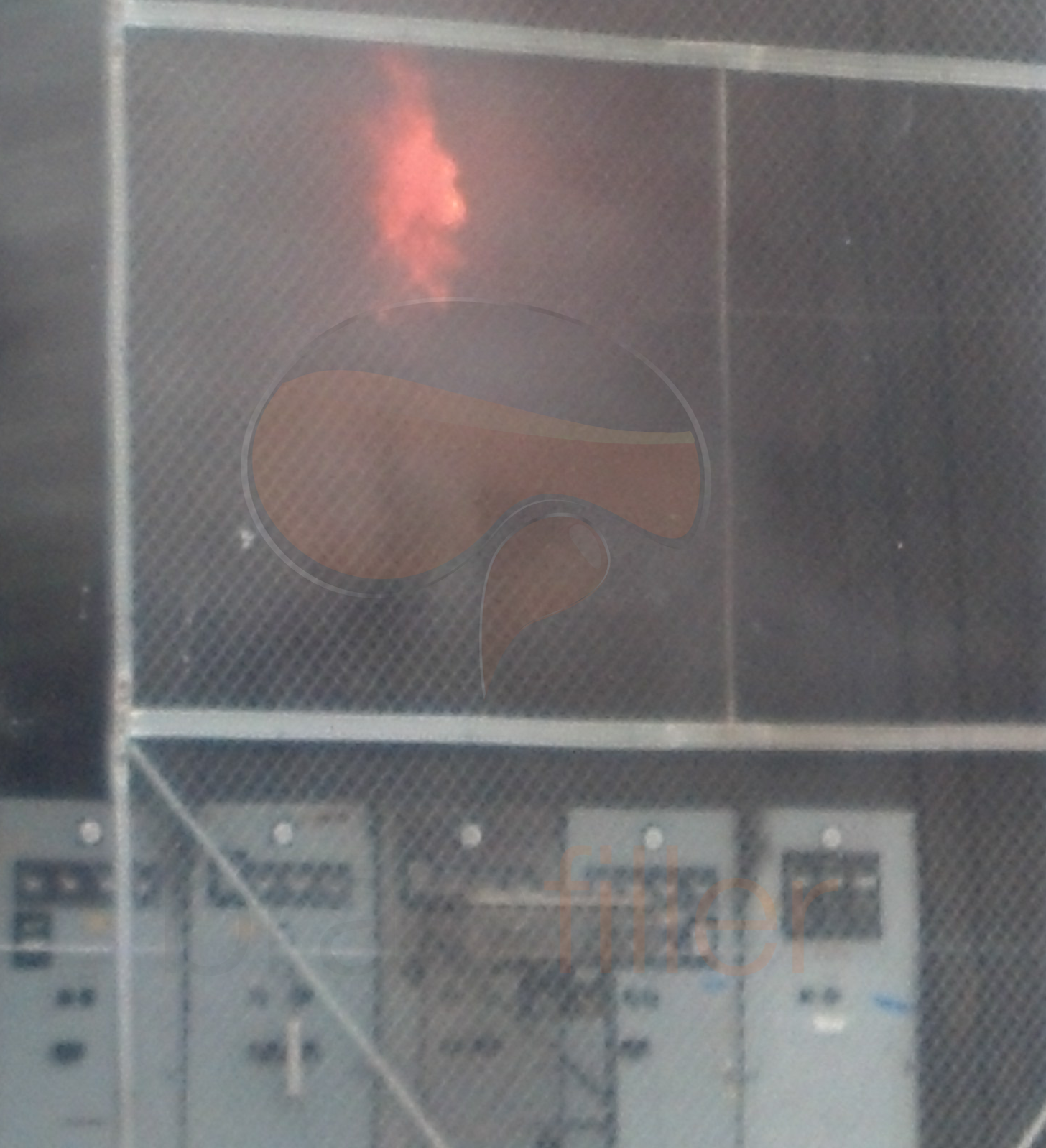

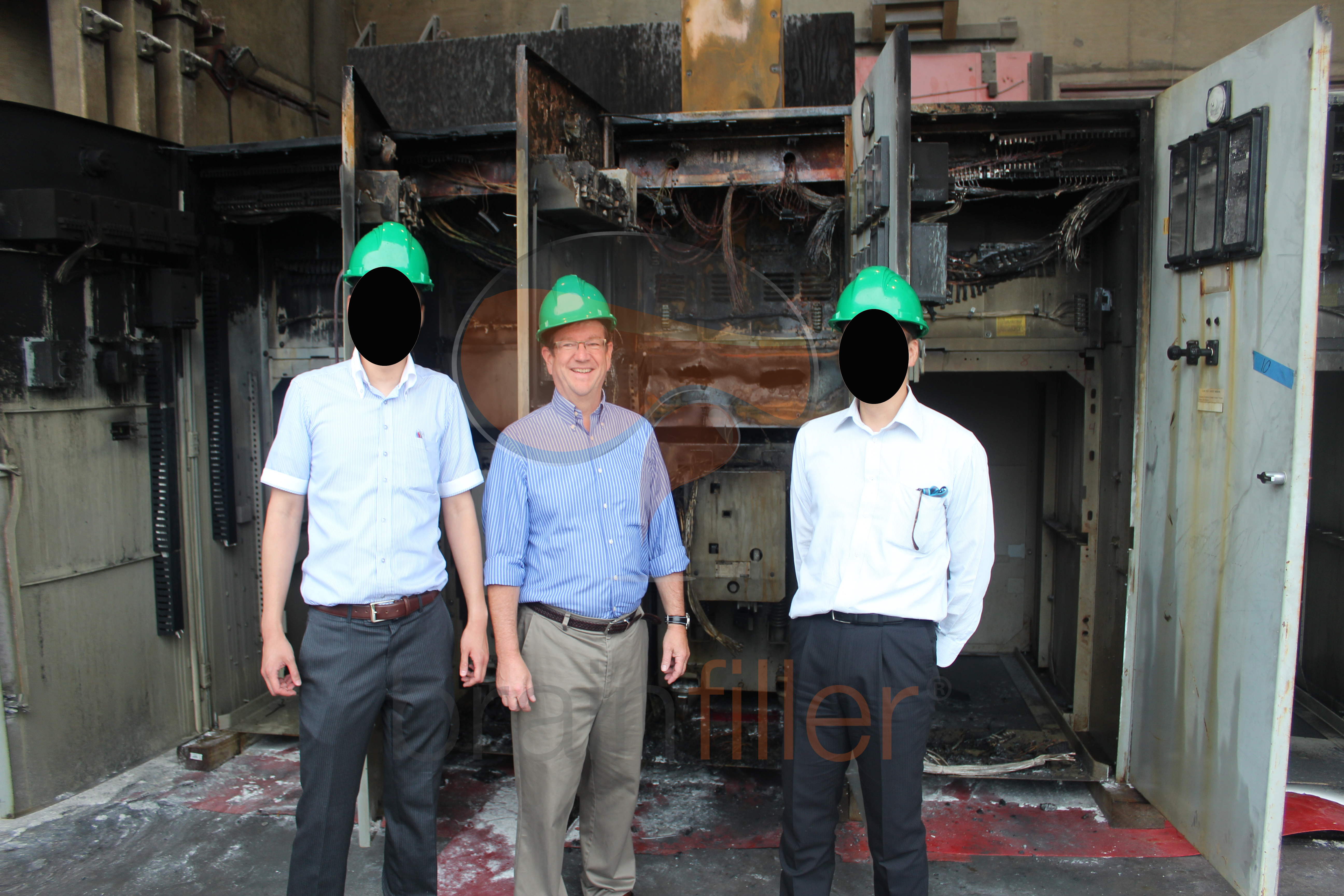

Hum, stories? Yes, I have a few arc flash tests go down the path of the unexpected. Here are two.
Burn down the lab
This was the best one ever for me. I was brought in by a research team for a Japanese delegation to determine how a nuclear plant caught on fire after the Fukushima earthquake of 2011. At the initial meeting with the Japanese delegation, I suggested a 9.0 earthquake might shake the switchgear so violently that the bus could make momentary contact and initiate an arc flash. They had not heard of an arc flash at that time so a few demo videos later and we were on our way for a recreation later that year.
One of the tests gave them exactly what they wanted. An arc flash catching the MV switchgear on fire – aftermath in the photo. There was a wireway at the top packed with the type of conductors used at the plant. The 3 second arc flash ignited the conductor insulation and the wireway acted like a chimney with a perfect draft going.
With flames shooting towards the ceiling (see photo) the delegation asked me how to put the fire out. With a very straight face I stated, I have no idea. I was brought in to blow it up, not extinguish it. After a panicked 15 minutes, someone with a garden hose and lift extinguished the fire by flooding the wireway. The damage looked quite similar to the photos of the switchgear from the nuclear plant. A success! (with some excitement)
