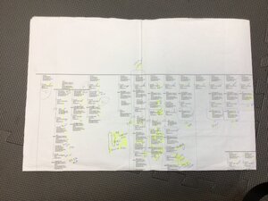

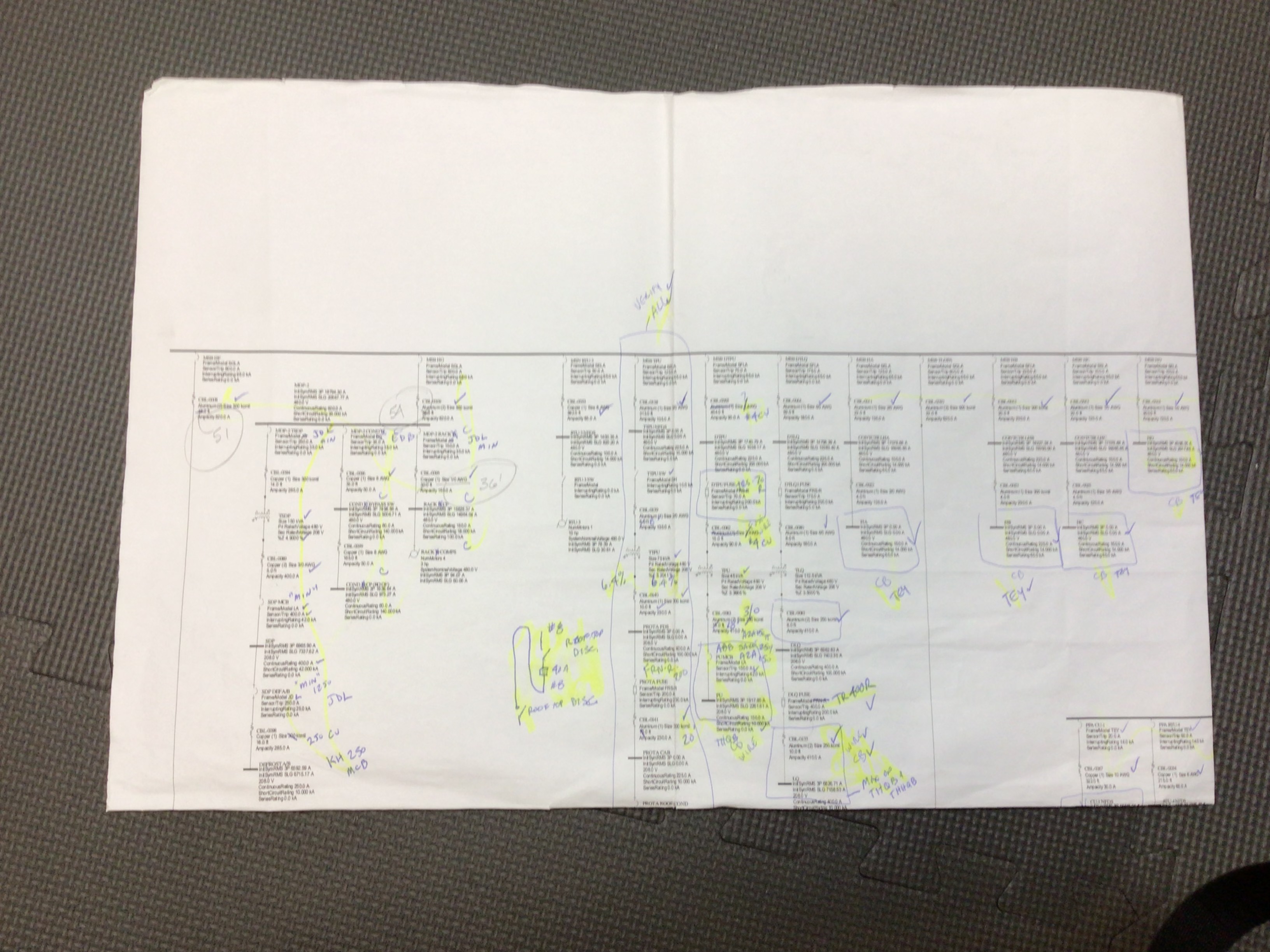

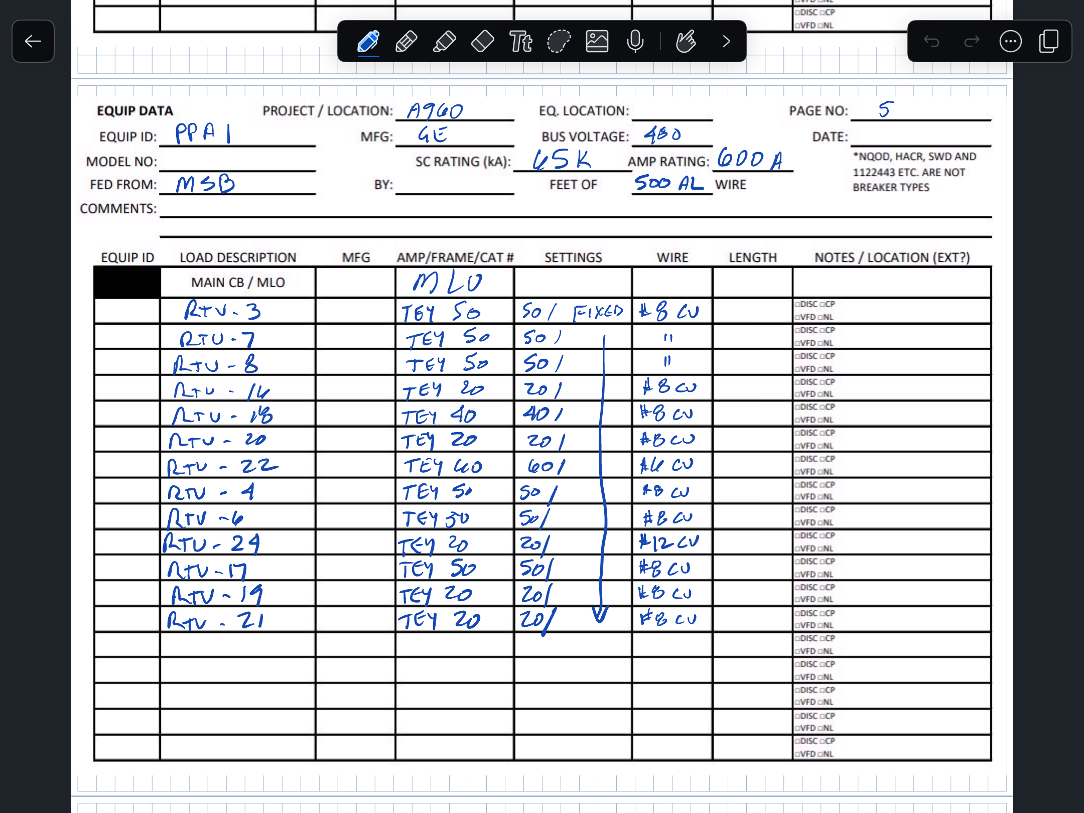

If it is a small job and I have as-built drawings and submittals I normally model it first before I go to collect/verify the data and just work off a hard copy printout and mark it right on the drawing.

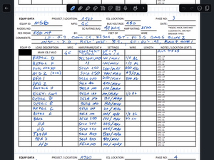

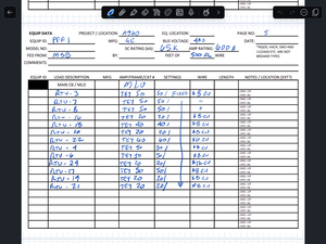

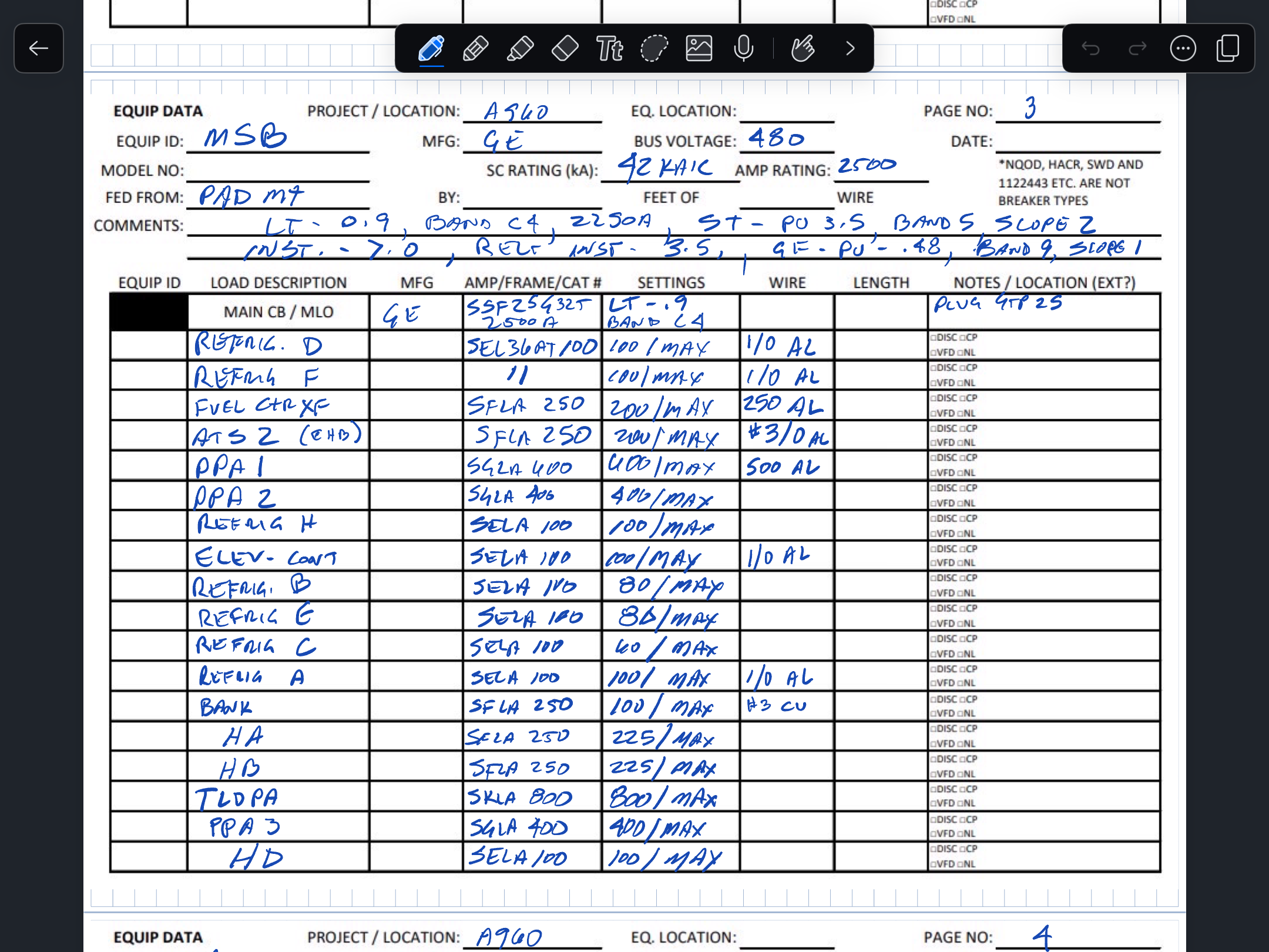

If I don't have any drawings or it is too large to work off plots of the model I use a Notability on my ipad.
Examples below. I don't use the SKM mobile version. Never even checked it out. Probably should.
 Post subject: Re: What do you guys use to collect data?
PostPosted: Thu Jun 13, 2024 5:44 am
This is weird. The preview thumbnails don't match the pics. If you click on the pics they are correct though.

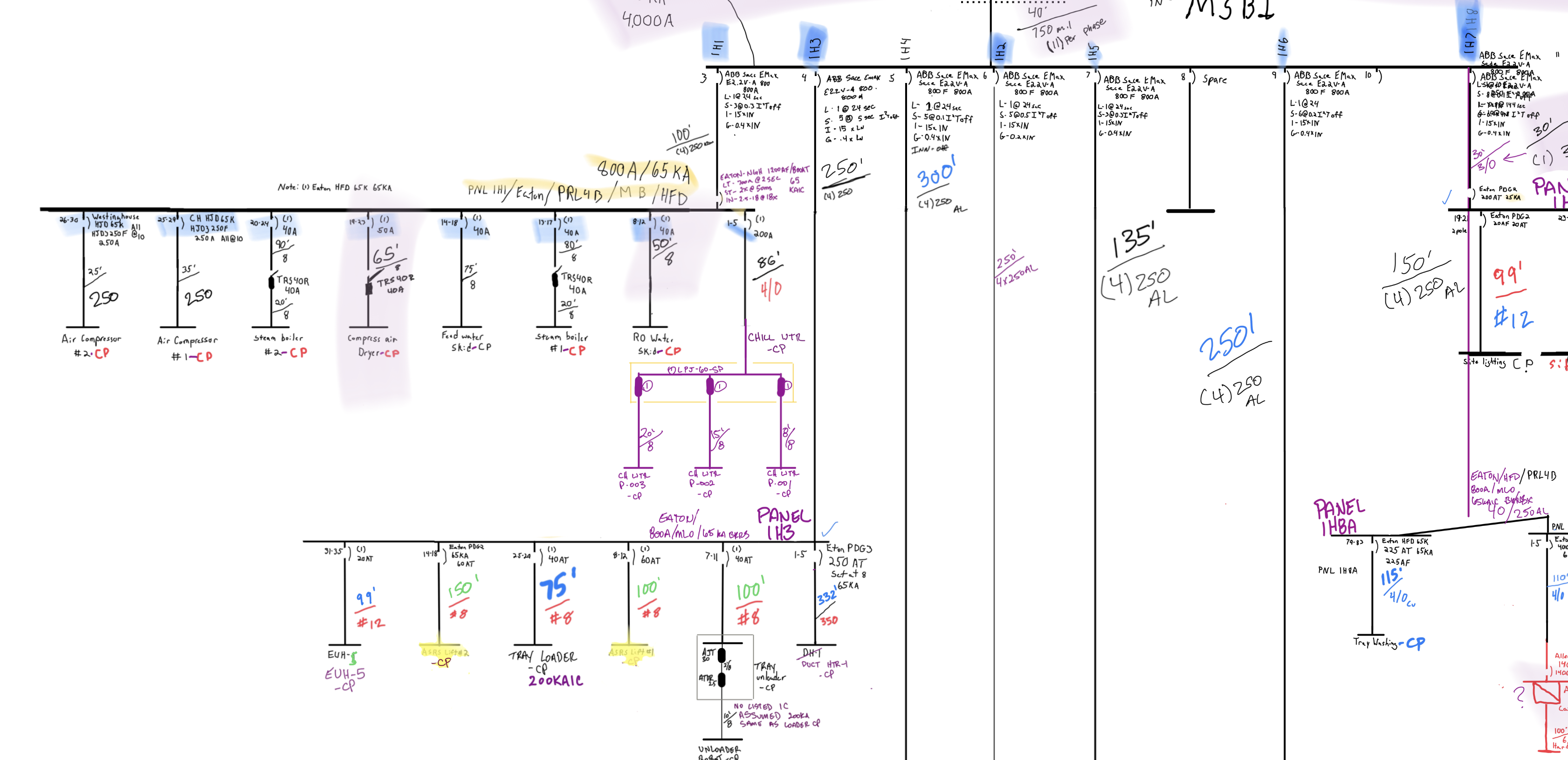

I have Skm mobile but haven't used it yet. A lot of the data collection I've been doing has been done on Easypower. I have attached an image of how I've been doing it.
Does Notability allow for multiple users at the same time?
