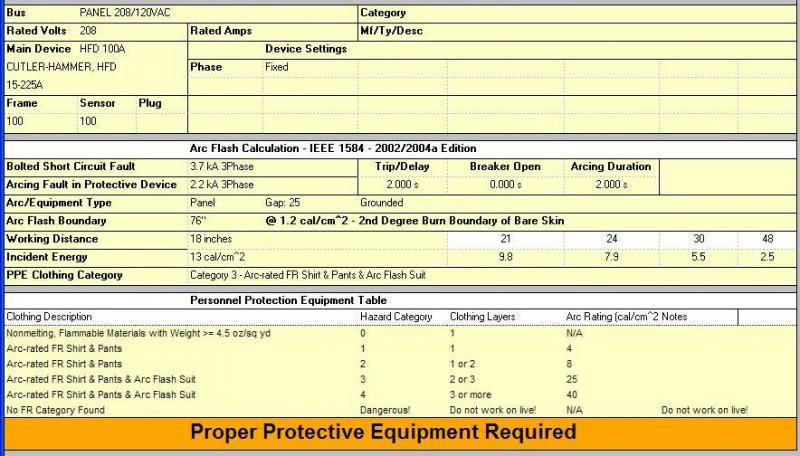

Specify that the electrical contractor has documented proof of arc flash training and is equipt with the proper ppe as part of the contract.
PostPosted: Thu Sep 03, 2009 2:08 pm
Yep, use this

Well that form covers the facility for liability, I suppose you could ask for proof and documentation of the required training.
As far as qualification and "approved" training it is up tp the employer to determine what training (Classroom and hands on) is necessary to meet the 70E requirements to deem thier employees as "qualified" persons.
