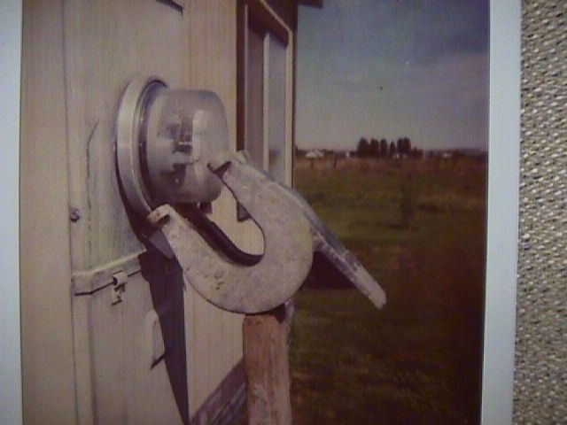

PostPosted: Fri Jan 29, 2010 8:38 am
Canuck01 wrote:
In my example, no instantaneous trip element in the MCC OCPD combined with a very high cable impedance leads to a high IE. I absolutely agree the hazard can be engineered out - all it takes is time and money! One negative about performing a study is that you find out how much work you need to do (and how much it will cost).
In the meantime, all Haze's comments are valid. What about the guys that go out and service machinery? Before AF regulations they could go into the field and lock out with impunity. Now they must abide by the label even though no-one can provide the data to prove their type of interaction is dangerous. It's not right but not completely wrong either. That's why I think risk ranking is the way to go regardless of the system characteristics. Safe or not - that should be the test. I'll live with my high IE's when exposed to the hazardous energies but why do I gear up when the equipment is being operated as it was designed (turning on and off a breaker or switch).
This is why
