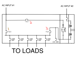

 Post subject: UPS Model
Posts: 18

For SS/AF calc's: i only model the UPS static bypass, since during a fault condition, it will transfer to bypass any way and deliver the full fault current the system has available to the fault.

Fully Agree.
