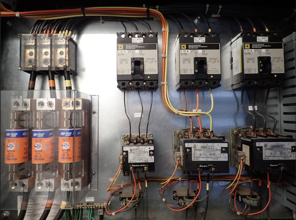

Here's an example photo of what I'm talking about.
File comment: Here's an example.
