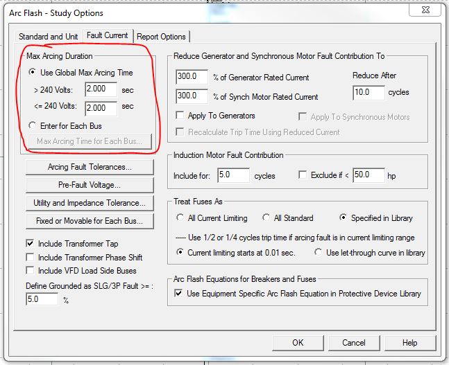

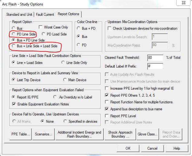

I've only used ETAP a little and it's been a few years.
In SKM you can select to calculate incident energy on both sides of a protective device. Not sure if ETAP has that ability or not.
If not, you could try adding a bogus device whose curve is outside the limits so it won't clear and let the 2 second rule kick in. If you can find one.
 Post subject: Re: Which bus to fault? Switchgear + Generators
PostPosted: Wed Apr 04, 2018 12:32 pm
A couple screen shots from SKM. Maybe you have this in ETAP too?

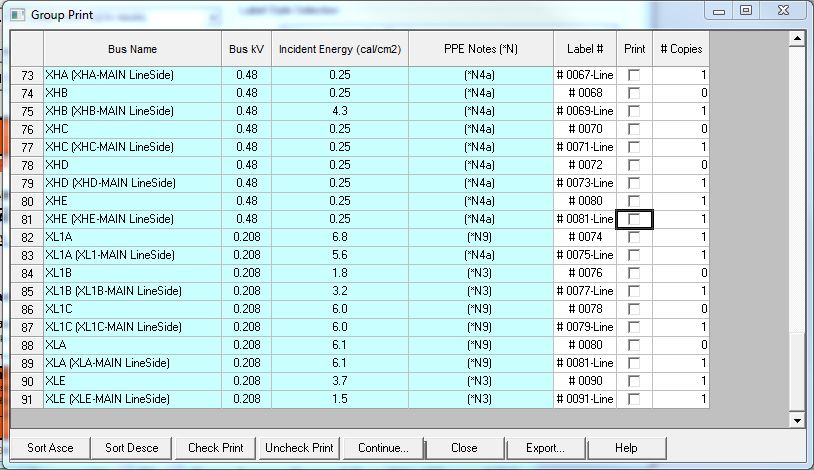

Hi Bbaumer,
So when you calculate the arc flash levels / incident energies on both sides of a protective device, which one do you use for the label? the worst case scenario / i.e. the higher incident energy?
PostPosted: Mon Apr 09, 2018 7:11 am
mbk.2k3 wrote:
Hi Bbaumer,
Generally, yes, I select the higher value for the label. If the values are the same I select the line side of the main so the upstream protective device on my label is accurate. Here is a screen shot of a model with several panels that all have main breakers.
PostPosted: Tue Apr 10, 2018 11:39 am
Joined: Tue Jan 05, 2010 10:52 am
Posts: 6
You can double click the bus and go to the arc flash tab. Select fixed fault clearing time of 2 seconds (or whatever) and it will calculate IE.
