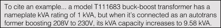

I'm asking because Buck-Boost Transformers operate as an autotransformer, and can supply a load much larger than its nameplate suggests. See example from ACME (Hubbell) website http://www.delzer.com/hubbell/acme_cat/#122/z on page 122. Buck-Boosts can be up to 10KVA+ in size, and could potentially supply a load of 200KVA, depending on voltage.
Buck-Boost Transformers ARE THE SAME as an isolation transformer, just with terminal connected in a different order. So if you observe a 10KVA transformer on a branch circuit, you might ignore it. But if that is supplying a 100KVA load at 240V, it would be a mistake to overlook that since you would have 240A of load.

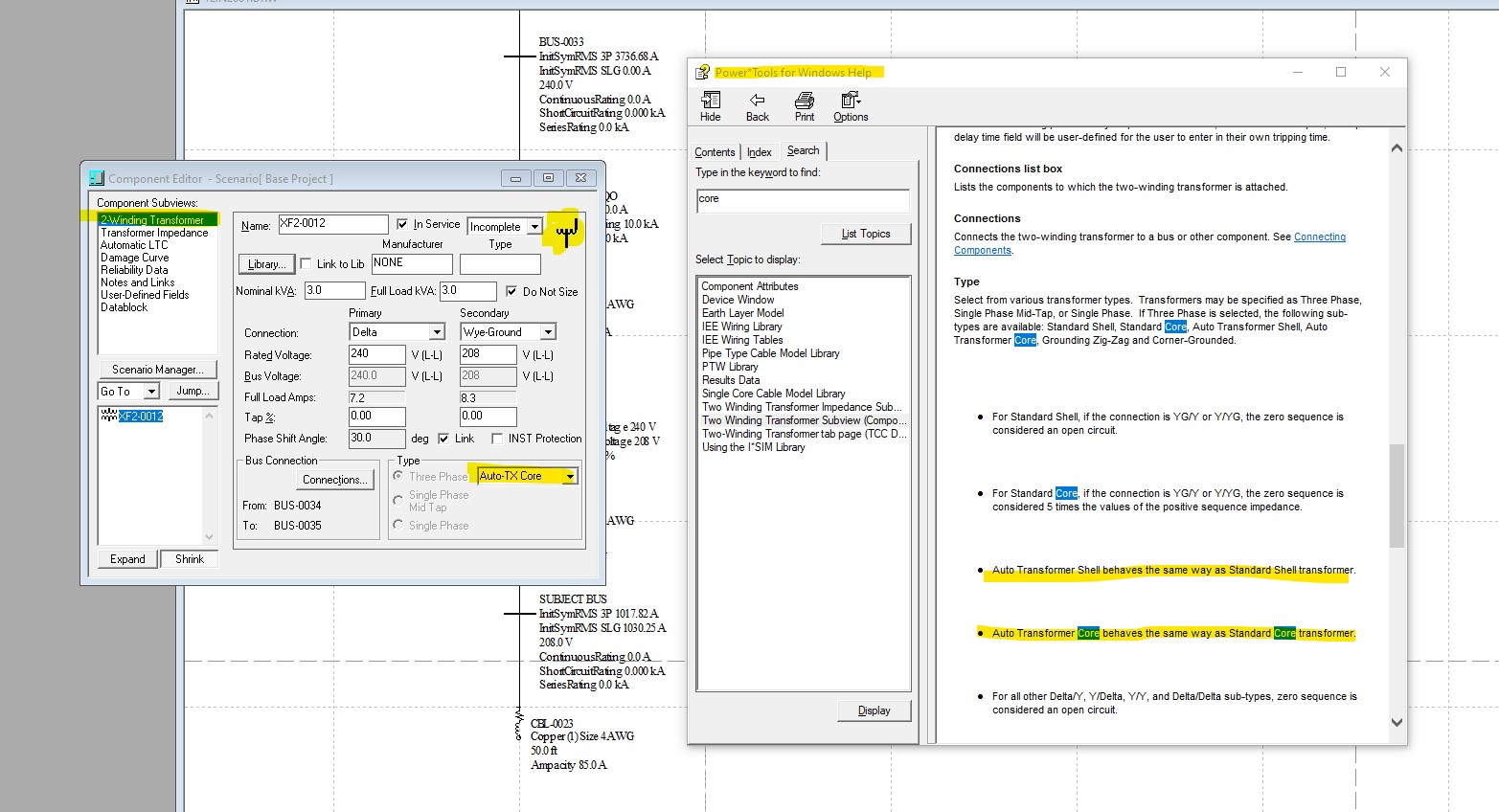

SKM Power Tools has a TYPE option in the Component Editor where you can select "Auto-TX Shell" or "Auto-TX Core" but it doesn't seem to do anything. I don't see another way of adding an Auto-Xfmr. Can ETAP or Easy Power do this?

I think you're right that changing the connection type in SKM to Auto-TX Core doesn't do anything. Here's what SKM Help says on it:

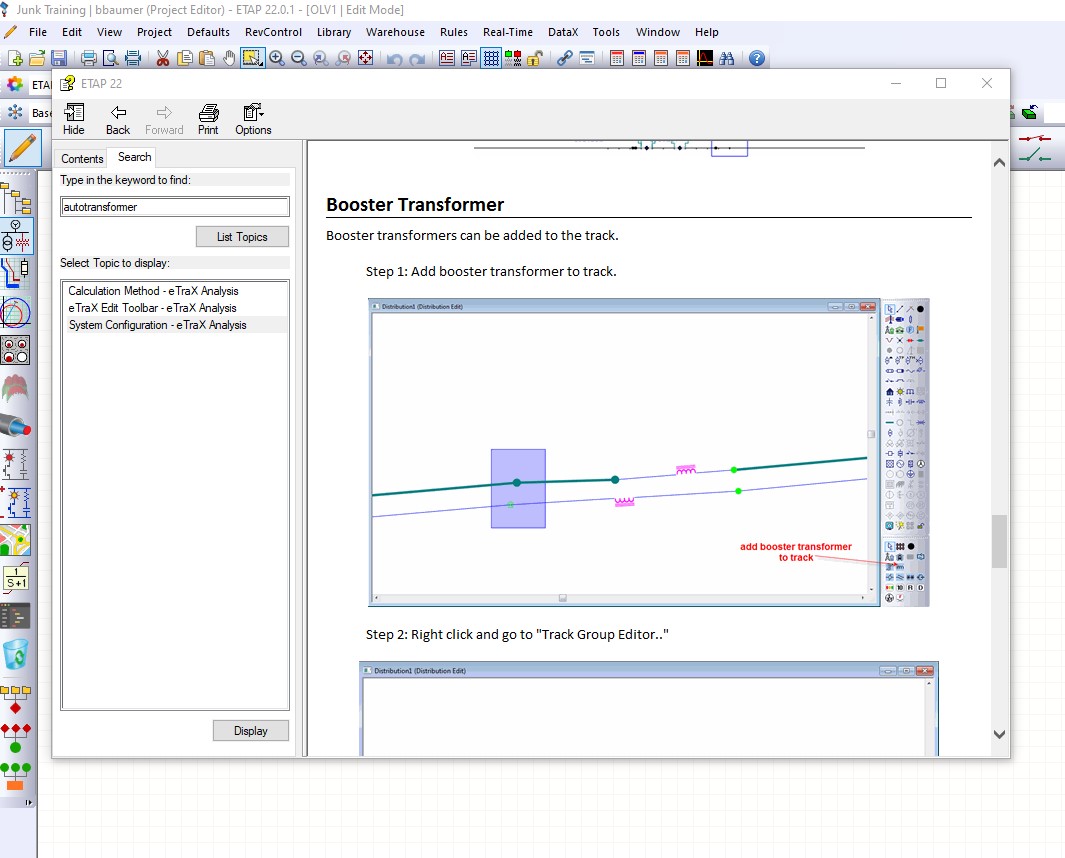

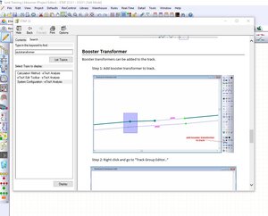

I don't know about EasyPower but I did a Help search in ETAP after I could not find that option to add an autotransformer or buck-boost in ETAP and it came back with this, among other things:
That said, my experience level with ETAP isn't nearly what it is with SKM and I have not used whatever modeling method or operation ETAP is referring t there. If you have ETAP maybe you can do a similar search and get your answers.

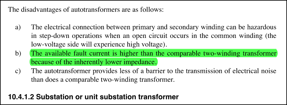

Thanks for looking into it and the info. I happened to stumble across this in the IEEE Std-141 Red Book, Chapter 10 section 10.4 for completely different reasons.

Thanks for sharing that info.
