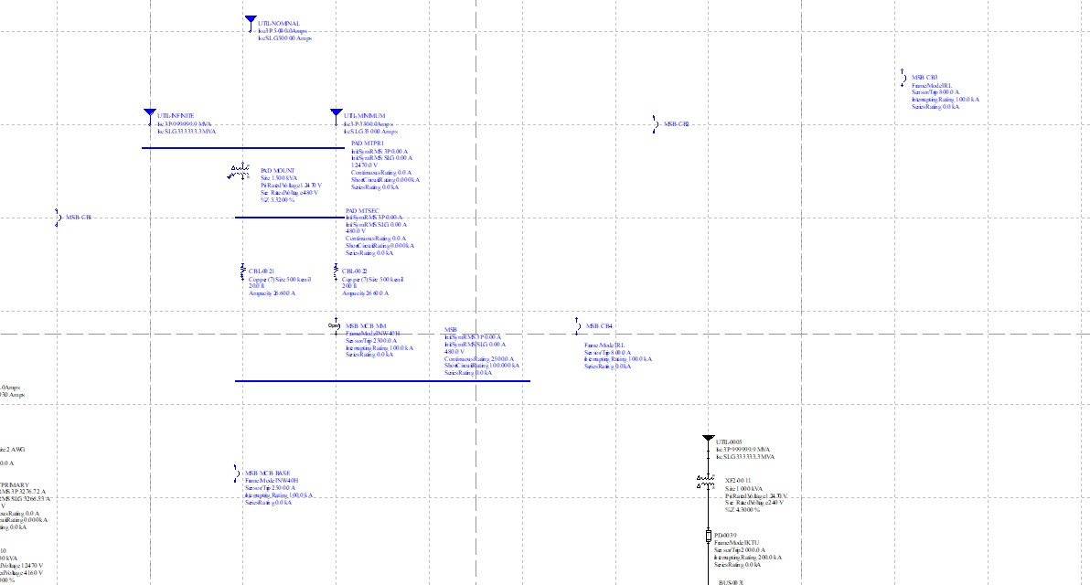

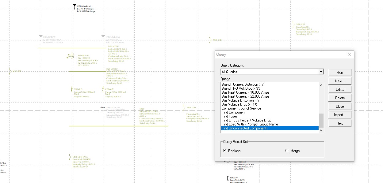

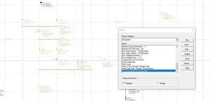

I looked at this a bit this morning.
You can right click anywhere in the one-line then do a Query on unconnected components and Run. It selects all the unconnected components that way. Right click again and destroy. That will destroy them all in a oneline. If your model has multiple onelines then you repeat for all oneline drawings.
