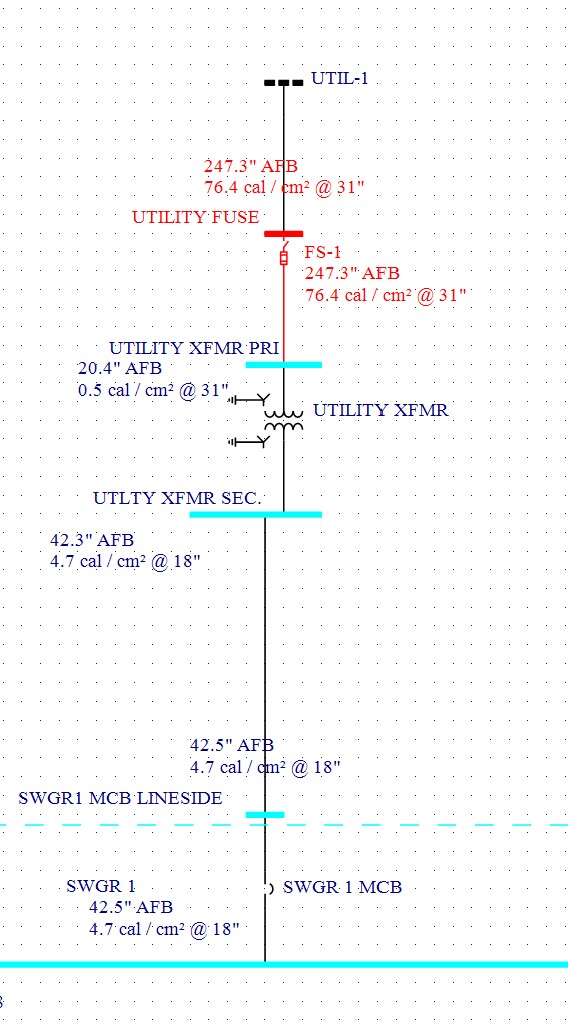

 Post subject: My Line side is the same Incident energy as my Load side.
PostPosted: Mon Dec 16, 2024 8:11 pm
I'm pretty sure I have this modelled correctly but I'm trying to figure out why my Line side and Load side is showing the same incident energy level. Does anyone know what I am missing?
