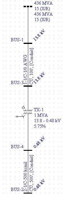

PostPosted: Tue Feb 05, 2008 9:27 am
Generator Time Current Curve
Hi Everyone,
This is a great discussion - lots of good comments and thoughts. I attached a time current curve that hopefully helps the cause. It looks like the generator MCCB with a high setting would probably not trip according to the generator decrement curve. If the fault current is arcing, the liklihood of the breaker tripping goes down although at lower fault currents, the difference between bolted and estimated arcing currents shrinks. So now the question is:
1) Could the arcing current sustain itself?
2) If it does sustain itself, would it last as long as it takes for the breaker to trip according to its curve (I doubt it)
3) Do you cut the time off at 2 seconds (makes more sense but could give high HR category using 120 cycles)
4) Do you use the 70E Tables which have limits on the arc duration in the footnotes that would be exceeded
I'm not sure there is a right answer yet (I'm not sure if that means there aren't any wrong answers :cool: ) This seems to be another one of those cases where we are trying to get precise with a piece of the puzzle while the main IEEE 1584 equations aren't that precise (yet)
And..... to make this more exciting (??) the NEC requires that the emergency and legally required systems must coordinate with the supply overcurrent devices i.e. generator breaker would ususally be set high for coordination - :eek: Augh!
I am interested in anyone's comments and thoughts - this is a good one!

PostPosted: Tue Feb 05, 2008 1:10 pm
Location: St. Louis, MO
1) I don't think the arcing current would sustain itself. I'm hopeful that more studies will substantiate this. There have already been some studies that suggest that most LV arcs will not sustain for more than 2 seconds.
2) See 1) above and 3) below.
3) A 2 second cut off would give overly conservative results. I try to make my calculations as accurate as possible. This increases electrician buy in and gives the program more credibility if something does go wrong and a flash occurs. This could also result in workers being overly dressed and unable to perform their jobs effectively. I still go with the 6 cycles at full arcing current, with a subsequent reduction to 100% rated current. In place of that, 10-30 cycles may give a close approximation without going too far.
4) The tables cannot be used in this instance. They simply fall outside the scope. Outside of that, the alternative is to have a mixed :( system of calculations and tables. (In this case, for the same voltage levels.) A bad combination sure to bring your program into question.
PostPosted: Tue Feb 05, 2008 7:56 pm
Posts: 520
Location: New England
Small generators like this generally use molded case circuit breakers which are 80% rated. So a 500A breaker should not be loaded to more than 450A, which matches the generator output FLA. Installing a 450A breaker would shift the curve to the left and increase probability of tripping, but you would have to carefully monitor continuous load conditions and therefore not be able to use full capacity of the generator. This could be overcome by changing to a 100% rated breaker at 450A. You would stand a good chance of being in the instantaneous range and tripping in 2 cycles then.
I don't have the backgound of knowing arc sustainability, but my gut feeling is that sustaining an arc at 800A after 1 sec seems very unlikely, especially at typical gap distance.
PostPosted: Wed Feb 06, 2008 5:52 am
brainfiller wrote:
I had a copy and obtained approval from it's source at PG&E. It was presented at one of our IEEE 1584 meetings about a year ago. It confirms what Catcher stated. There are a few graphs of data points as well. It shows that we are still learning the physics of arc flash and have a lot of work ahead of us. You can download it at:
[url="http://www.brainfiller.com/documents/PGETestingbrainfillerposting.pdf"]PG&E Presentation[/url]
I added an intro page on it just so people know what it is based on and to use it at your own risk.
I agree with not being able to sustain the arc. The question I posted earlier was more rhetorical just to see what everyone else thought. Above is the info I posted a while ago about arc duration testing that was presented at one of the 1584 meetings. WDN, I think the shorter clearing times you are using make sense - maybe someday we'll have some solid "official" direction but for now, it's great to see everyone sharing their views to work through this. Haze, you are right, the 450A breaker would stand a better chance of tripping than the 500A under these conditions but as you correctly pointed out, it is ususally only 80% rated.

Jim,
Why does the Generator Decrement curve divide into two branches at the bottom? Are you trying to show min an max values?
PostPosted: Thu Feb 07, 2008 1:57 pm
Haze, great question. I probably should have labeled it on the graph. The branch to the left is the AC current from the generator only. The branch to the right is the total RMS of the AC plus DC current. The DC component of the fault collapses pretty quickly - less than 1 second.
The total current could possibly trip the instantaneous of the breaker but I doubt it. The arcing value for this current (which I did not calculate) would be even less. The vertical band of the breaker's instantaneous represents the plus and minus breaker tripping tolerance. At best the bolted fault current just passes the minimum amount of current it takes to trip the breaker and the right side of the band means it could take a lot more current - not to mention the arcing current would be less. The curve depends on the generator parameters and I just used some typical numbers.
