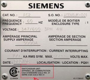

Is this a switchgear or switchboard? You say SWG, which I assume means switchgear, but you also mention 30 amps fuses and a panelboard.
It would be useful for you to post pictures. Specifically a picture of the nameplate on the gear as well as pictures of the gear itself and the room it's in. Seeing those could help members to get a better idea of the context.

I uploaded the SWG nameplate
File comment: swg nameplate

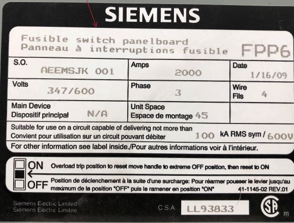

and the panelboad nameplate, SWG front compartment starting cubicle 3

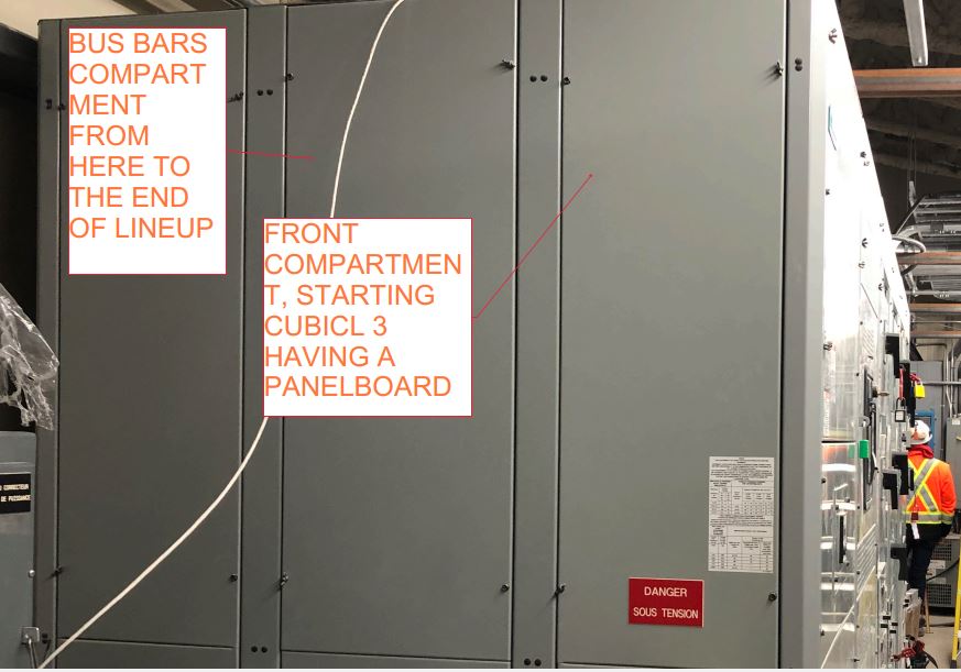

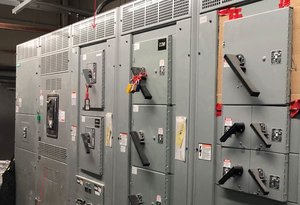

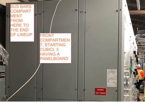

SWG front and side view

I treat that type of construction as having (1) Arc Flash value, based on the incoming lugs, for the entire switchboard line up. I don't believe there is an internal compartmentalization at all. An Arc Flash in one of the fusible switches could easily propagate to the horizontal cross bus and then across the main protective device.

Looking at the ID tags and photos, This gear does not look like it is a switchgear. Based on the photos, I'd urge you to treat the entire gear as a switchboard and label the entire swtichboard with the highest arc flash calculation, that is UNLESS you can insure the main breaker is properly isolated from the rest of the switchboard.
My concern is propagation of an arc that starts inside the main disconnect cubical. If the main breaker is properly isolated by a barrier from the rest of the board, then you could consider labeling with two arc flash values. One at the main and one for the rest of the board. The arc flash at the main breaker is probably very high. But I'd imagine the arc flash values fall sharply after the main breaker.
There are some options to consider. First, I'd contact the manufacturer (have the ID tag available) and ask if the main breaker in this gear is isolated to prevent an arc from spreading to the rest of the gear. Second, you might consider the fusing on the primary of the transformer feeding the board. If this is a utility provided and owned transformer, you should be able to get information on the fuses. It's possible the fuse may help limit the arc flash, however, I don't think considering the fuse is necessarily a wise idea and I don't think relying on a primary fuse is always wise. Finally, if the manufacturer states that main breaker is isolated to prevent an arc from spreading to the rest of the board, does the main breaker have an "instantaneous" trip option? If it does, it's likely the instantaneous trip could be set to reduce the arc flash hazard downstream in the switchboard portion. It is also possible there's a maintenance setting or switch on the main breaker. If there is, I'd recommend using the maintenance switch or setting when working on the switchboard.
