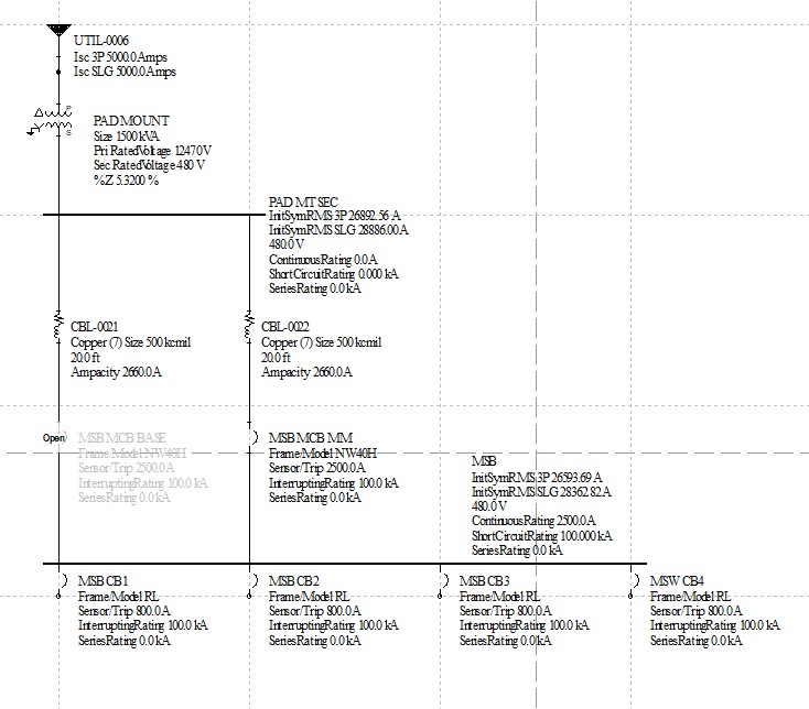

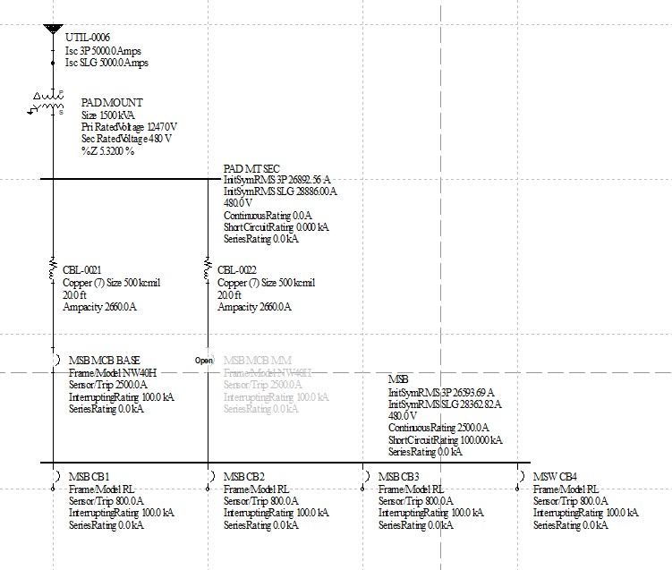

Unless I'm misunderstanding I don't know why you couldn't model two main breakers in parallel, one with the normal settings and one with the maintenance mode settings and put the MM breaker out of service in the base scenario and the normal settings out of service in the MM scenario. No scenario would have both main breakers in service at the same time.
 Post subject: Re: Arc energy reduction mode labeling
PostPosted: Thu Jun 22, 2023 12:54 pm
Example. Base MCB is normal operating condition. MM MCB is maintenance mode operating condition.

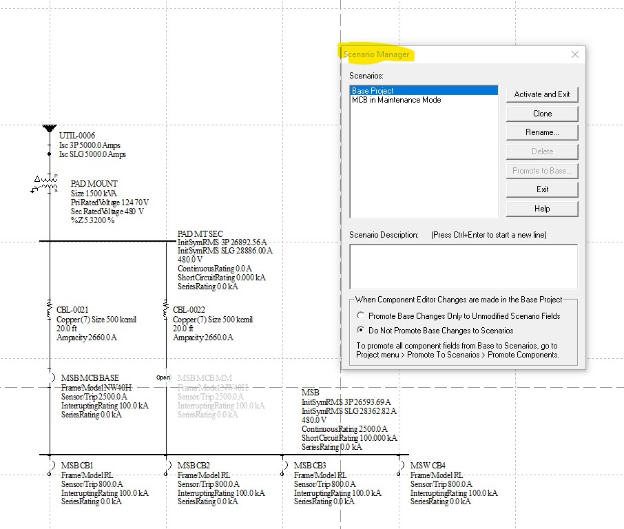

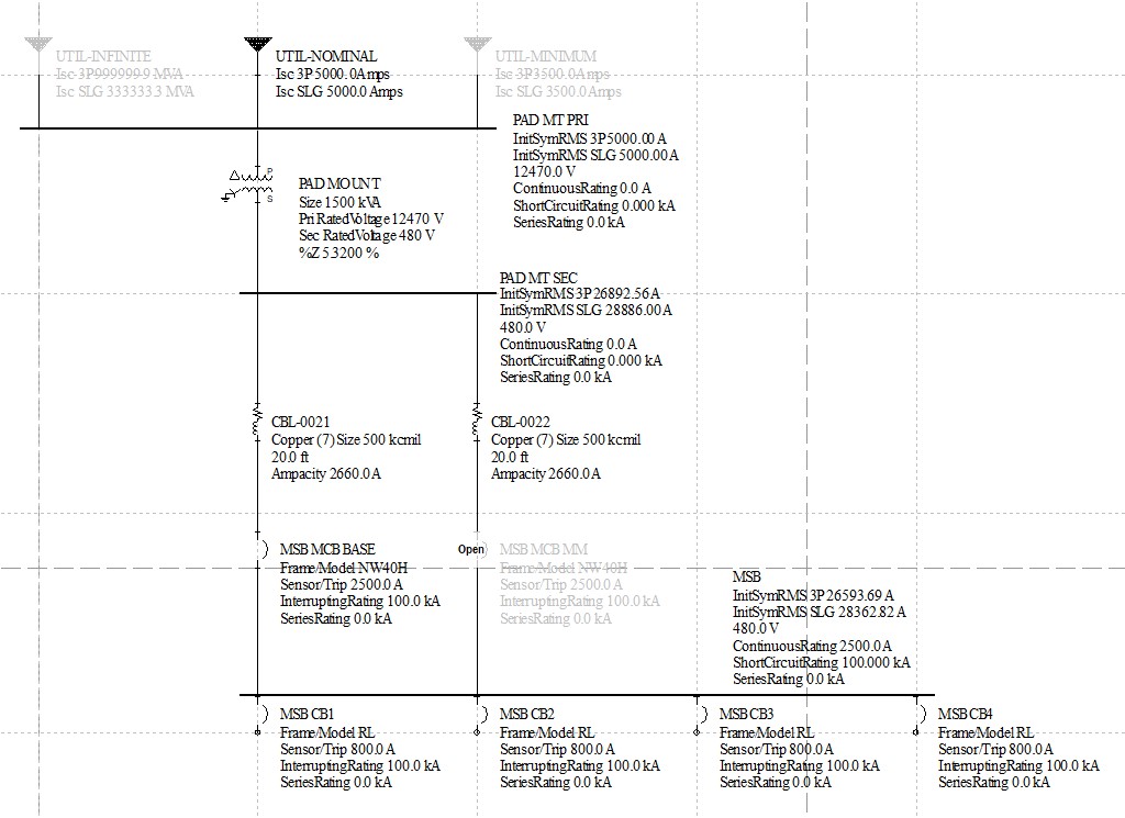

Incidentally, some engineers use this same methodology to analyze the available fault current from the utility. You can do it this way or change in each scenario in the Scenario Manager or a combination both. I like doing it this way sometimes (depending on what I'm analyzing) so I can see the effect of one vs. the other very quickly without having to leave the base model and go to each scenario.
For example: Infinite bus, Nominal from Utility and Minimum from Utility with Nominal in service and the other two "off":

Thanks for the input on this. I had not thought about creating a separate set of breakers with maintenance mode settings. That's not a bad idea if there is just one or a few. At a minimum it will double the number of scenarios that have to be analyzed. The systems I'm dealing with have numerous breakers with maintenance mode capability. They are connected to a central control system that enables MM for all breakers concurrently, or they can be controlled locally, individually. As you mention that seems to create a nearly infinite number of permutations. We could just run the case where they are all in maintenance mode I suppose.

That's what I would do (all Base scenario vs all MM). I don't know the particulars in your case but I don't label maintenance mode. That scenario could in the report that resides in the facility managers office. It's likely only one downstream panel or switchboard will be undergoing energized maintenance at a time, I would guess. The boss can look at the report and tell them what PPE is required if they flip the switch to MM.
