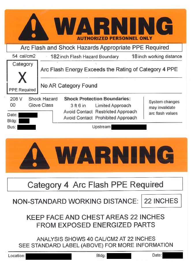

This squirrel got into 12 kV without proper PPE.

Tough day at the office? :)
