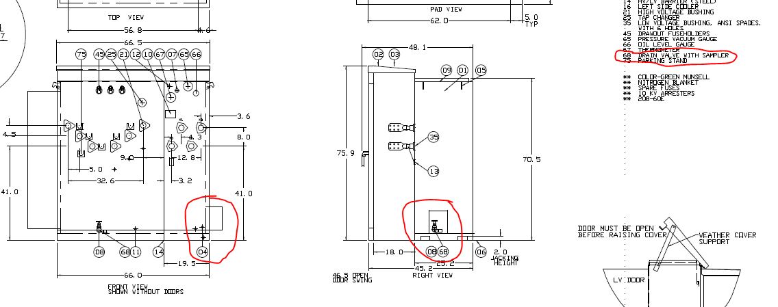

RE: Oil sampling, I'm too lazy to look it up at the moment but I'm sure we have over 100 oil filled pad mounts on campus. When we buy new ones we do use remote valves. We have also retrofitted a fair number of the old ones. There are still a lot to do though. It takes time and money and most of all the ability to schedule outages.
 Post subject: Re: Modeling Bay-O-Net Fuses in Pad Mount Transformer
PostPosted: Wed Feb 01, 2017 10:55 am
All the manufacturers CAN put the oil drain line/sample line outside of the termination cabinet. The reason that they don't is because 90% of the business is with utilities. The utilities want a vault style access at the front of the enclosure and they want everything locked behind a door with a pentagon bolt and a padlock with nothing for Joe Q. Public to mess up if they get into the substation or especially if it's feeding a neighborhood. That means the gauges and the valve go INSIDE the cabinet.
You can order it the other way...with the oil line outside the enclosure. You just have to ask for it. It will be an "engineered" design that way but generally they don't soak you on the pricing for an almost cost-neutral change. That's my experience at least with Cooper, ABB, Vantran, and Howard.
It's also just plumbing fittings so as mentioned you can just extend the line yourself if you want to but it sort of requires pumping down the transformer most of the time to avoid losing a lot of oil in the process.
This is a pretty accurate assessment in my experience too. We have mostly Cooper pad mounts, then ABB then a host of others. Some of ours are old enough that they contained PCB's at one point in time. We've had them pumped out and the oil replaced but we still have to monitor them for it (PCB's) as it is impossible to get 100% of the old oil out. We also have the typical dissolved gas analysis done too of course. The oil in 90%+ of ours was tested for years without shutting them down and with the valve inside the cabinet. It's only been in the last couple of years that the company we use to test became arc flash aware and will no longer will pull a sample without either a remote port or the transformer shut down. That's when we started to order new ones with the lockable remote valve box and began to go back and retrofit the existing ones. The adder is peanuts compared to the cost of the transformer.
We also typically use EnviroTEMP or equivalent vegetable oil on the new ones. We have lots though with R-Temp.
Oh - "back in the day" (i.e. several years ago) the testing company pulled a sample from a set of 3 single phase oil filled cans (wired for 3 phase) we had in a vault by drilling a hole in the side of each tank WHILE ENERGIZED and thought nothing of it. Said they "did it all the time".
