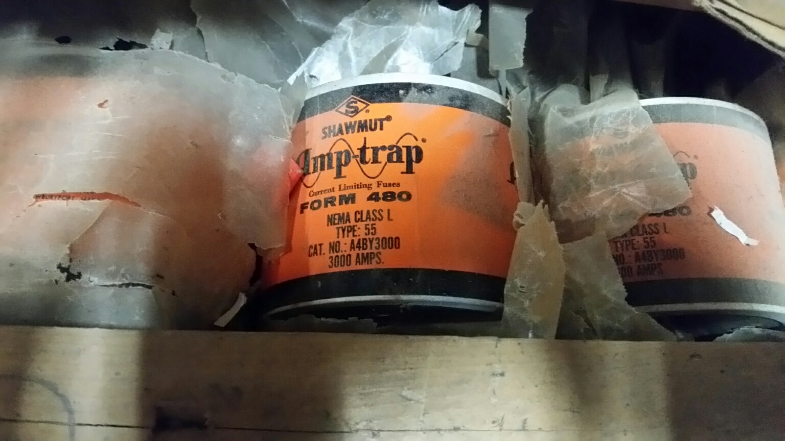

Yep. We have some fairly biggun's around here:
These are still in the crate and I'm not man enough to pick the whole crate up with one hand to take a pic like I did with the 2500A:

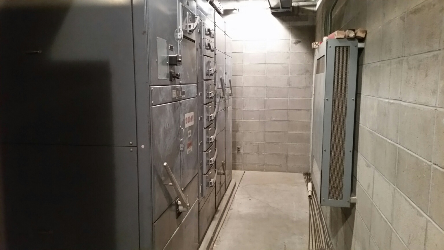

We have a very large dorm that was built in the early 60's with a 6000A 208Y/120V service in it. I don't know if it ever had 6000A fuses in it. I know it has 1600A fuses now though. We installed a campus-wide metering network back in 1999. After a few years of collecting data we were comfortably able to reduce a ton of main fuse sizes based upon actual load data.

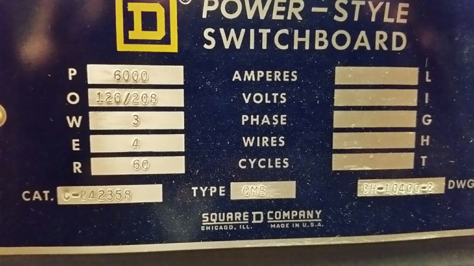

Just 'cause I mentioned it. I was out and about early this morning and took a couple pics:
I'm told this switchboard did indeed have 6000A fuses in it at one time but the actual load was far less and the fuses were changed out to 1600's.

Believe it or not this dorm actually has two 6000A services (well, really feeders by NEC definition of a service. Our "service" is 34.5kV from the utility company). It was set up to be able to tie the two 6000A boards together in case one of the primaries was lost but the then "future" tie switches and 6000A feeder tie bus was never installed.
This dorm is quite large, 10 stories, 532,000 SF. But still, the company that designed it believed in over-design in every way. They didn't start using 480V until the early 70's from what I can tell. I've not done an SKM model on it because we are tearing it down starting this summer.
