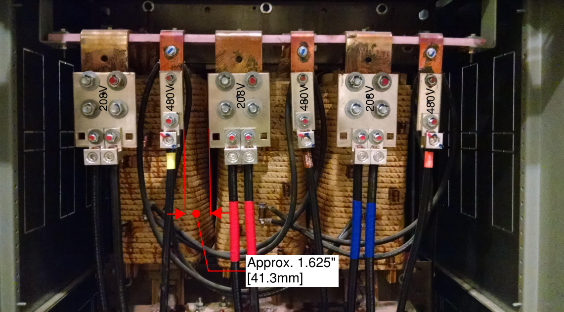

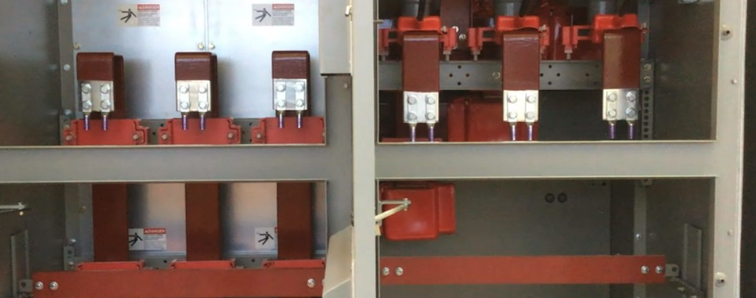

Ahh good question I have to say in previous studies I have seen locally they all include labels on transformers then I started to questioning the method in the way the IE was calculated when I would see “gap” distances varied from study to study or even on the same study either switchgear, panel, or cable connection, some based on the 208V some on the 480V some indicating the “worst case” between the two calculations digging into this further understanding on how the values change as the variable changes in the IEEE formula….After reading other form responses and talking with some end users, owners and electricians, I have come to the conclusion that they [low voltage dry type transformers] should not be labeled with anything more than the generic label indicating “Warning Arc Flash and Shock Hazard Present When Energized” other than that how to you calculate a value of incident energy and still protect your liability [always have to keep the lawyers in mind] when there is no defined standard to back up you assumptions…Even understating the “gap” for each transformer design from the manufacture this information can be gathered, however as previously forum member stated the primary and secondary terminations are typically intermingled H1, X1, H2, X2, H3, X3, XO in the low voltage dry’s with no physical separation between them so even if you know the “bus gap” if measured or provided by the manufacturer how do you go about calculating the IE? The commercially available software I have seen to date provides you a Primary Node or bus and a secondary Node or bus but dose not accurately reflect the construction of the transformer configuration with both primary and secondary intermingled in a common enclosure. I do agree when dealing with liquid pad mounts with live front they are typically barbered however because of the door construction and how they overlap you typically have to open the low voltage side to get to the primary but at least it is has an internal barrier and you can calculate both side individually, the same with a low voltage substation if you are terminating in the air terminal chamber with remote overcurrent protection then the voltages are physically isolated and a label could be applied.
