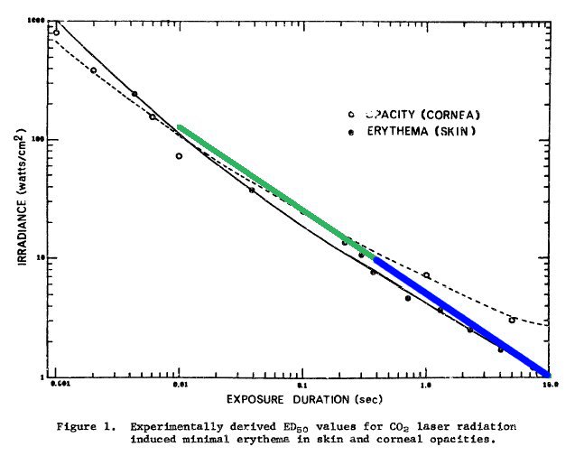

IF the Privette data is suspect is there some way to take experimental data to verify second degree burn data at times OTHER than say 1-2 seconds, say during short or excessively long intervals? Such as using samples of cadaver pig or human skin? Could it be extended upward and downward (1st and 3rd degree burns)? Is radiant heat energy the "right" way to model it? The terms plasma, hot gases, and molten metal keep coming up, and it's obvious that there are multiple phenomena going on but the distances may be wildly different to say nothing of the shape of the affected zones.
A. Brownell [A. Brownell, et al., “Ocular and skin hazards from C)2 laser radiation”. Joint AMRDC-AMC Laser Safety Team, Philadelphia, Pensylvania, 1972] provides test evidence supporting extrapolation of Stoll curve as proposed in [M. Furtak, L. Silecky, “Evaluation of Onset to Second Degree Burn Energy in Arc Flash”, IAEI magazine, July/august 2012]. Have a look on Figure 1 from Brownell's study:
For your convenience I've imposed on it Lines A and D Figure 1 from the IAEI arc flash article (blue and green lines respectively). Observe the correlation between the ERYTHEMA (SKIN) line with the Stoll curve in around 0.5 to 10 sec time interval. Note that, according to the graph, only 0.3cal/cm2 energy dose delivered within 0.01sec time interval is required to cause same damage as from 1.2(cal/cm2) dose delivered within one (1) second.
For excessively long time intervals, consider following example. Standing on a sunny day for roughly 20 minutes makes you exposed to approx 30cal/cm2 dose of radiation emitted from Sun. If severity of bare skin burn was determined in terms of incident energy alone, you wouldn't survive such exposure without wearing PPE 4 suit.
I strongly believe that, indeed, radiant heat energy is the right way to model arc flashes (hence the term "flash"). Laser, nuclear, pyrotechnic irradiation are all useful parallels to consider.

I got that all from the original article correlating data from several different sources of non-arc flash injuries. No reason to reiterate. You also keep plotting everything on log scales which is SOMETIMES appropriate (when it's an exponential) and at other times just tends to make everything look like a straight line when in fact it may not be.
Sorry if I've upset you by publishing the tests resuIts from A.Brownell [A. Brownell, et al., “Ocular and skin hazards from C)2 laser radiation”. Joint AMRDC-AMC Laser Safety Team, Philadelphia, Pensylvania, 1972] but I did it upon your own most recent request for more 2nd degree burn evidence:
I don't quite understand your concern with using logarithmic scale in the IAEI paper. The scale seemed to working well so far with A.Stoll, A.Privette, Brownell etc. works cited in this thread, and however many more other researches using the scale. Regarding your next observation:
My thought is though that this is all correlation and conjecture with non-arc flash related data while the concern is for the effect of an arc flash. You are making the case that based on indirect evidence that heat flux and not heat energy is the correct way to model this.
You could also argue that some of the Privette's tests series reported in [A. Privette, "Progress report for ASTM Burn Stufy", Duke Power Company, 1992] were conducted using a muffle furnace as the heat source and not the arc. And, yes indeed I am confident that heat flux should be factored in when evaluating threshold incident energy for a second degree burn. I'll take liberty to repeat the quote from A. Stoll [A.Stoll, "Heat Transfer in Biotechnology", Advances in Heat Transfer, v.4. Academic Press. 1967] summarizing the issue of using 1.2 cal/cm2 as a threshold incident energy to 2nd degree burn as well as any other heat dose to produce damage without regard for the speed of delivering the energy. The quote reads:
