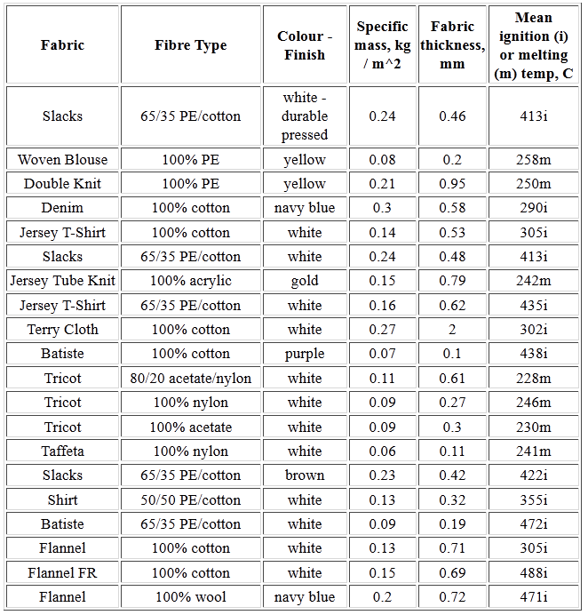

Behavior of Apparel Fabrics during Convective and Radiant Heating.
Personal protective equipment (PPE) recommended for arc flash is not always designed for arc flash exposure. The purpose of this paper is to warn of the dangers posed by using the improper materials in arc flash exposures until standards have caught up on this issue.
The table below shows a representative range of everyday textiles along with some of the measurements of importance in establishing their response towards convective and radiant heating[1]:
Table 1. Properties of 20 typical everyday fabrics.
Times to ignition or melting of the 20 fabrics in Table above were reported by Wulff[2], [3] for different incident heat fluxes. The Wulff's data have been used to develop a methodology by which ignition and melting times may be forecast. A semi-empirical relationship between ignition/melting time and radiative heat flux has been derived[1]:

Two things don't make sense to me here.
First, all the raw data refers to ignition, not melting. Based on my reading of the same reports the clothing acts as an insulator up until the point that it melts at which point it becomes conductive. So we're not really interested on whether or not it lights on fire but whether or not it melts. Technically the key point would be how much additional energy is accumulated by the victim (passing through the Stoll curve) but just as with many of the researchers looking at flash fire survivability it might be simpler to simply assume that once melting occurs, injury exceeds Stoll curve. And why this matters is that all the data is talking about ignition, not melting.
Second, and more self-contained, the data shows that at 0.01 seconds of exposure, the limit is 1.3 cal/cm^3 and then jumps to 4 cal/cm^2 at 1 second? This seems backwards.

You said, "Personal protective equipment (PPE) recommended for arc flash is not always designed for arc flash exposure. The purpose of this paper is to warn of the dangers posed by using the improper materials in arc flash exposures until standards have caught up on this issue."
PPE for arc flash is AR (arc-rated) so it is tested FOR arc exposure. The 2015 NFPA 70E has eliminated HRC 0 which was "implied" PPE but not recommended by ASTM or IEC standards.
ASTM F1506 is for flame resistant, arc rated fabrics and they are all "designed for arc flash exposure". Your post cited non-arc flash research which those of us who write the standards are aware of (it drove my research back in 1990's) but this is on mainly non-FR materials and none of the things you cite are related to arc flash. ONLY AR materials are supposed to be used in arc flash exposures. Don't understand what you mean by "until standards have caught up". The standards are light years past this info. Definitely don't wear melting fabrics or non-AR fabrics. Don't see any value other than that in this compilation of papers on convective and radiant heat. Additionally studies like this are basically useless (other than as a starting point) because the heat flux in an arc flash is much more than what is used in these papers.
I have combined both ignition and melting temperatures under one column. When the clothing ignites, a significant amount of energy is released. The amount of energy can be evaluated using the heat of combustion measure. I can provide you with heat of combustion values for the fabrics listed in Table 1 if needed.
This is right although it may seem "backwards". For exposures lasting less than one (1) second the heat flux required for ignition or melting the fabrics would significantly increase as the duration of exposure decreased. However, the amount of incident energy required to cause the damage would decrease.
