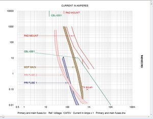

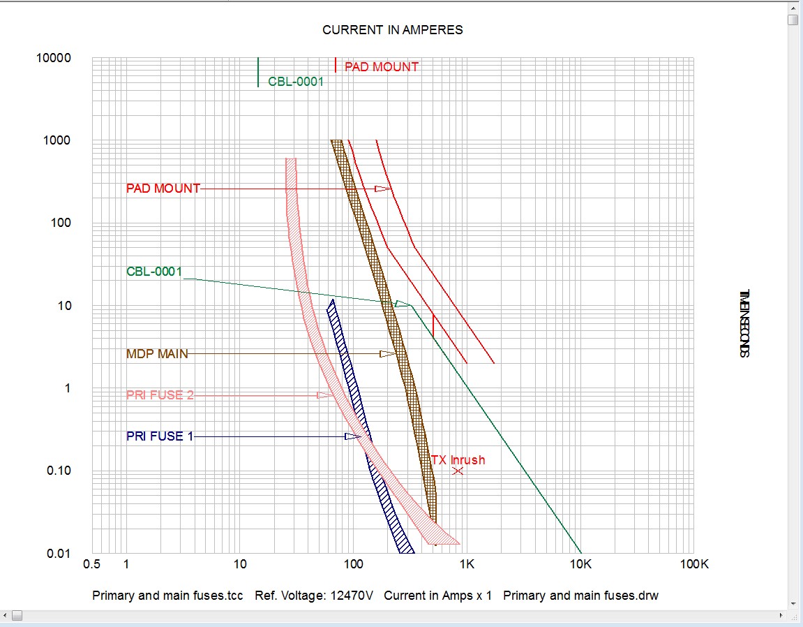

Hi all. I have a pad mounted transformer with internal primary side 15KV rated fuses. There are two types in series. One is an expulsion fuse GE# 9F54WLD303 and one is an oil submersible protector (OSP) GE # 9F59TCD150.
I don't have them in my SKM library. I asked SKM for them and they sent me new .lib files for these but would not guarantee them. After merging them into my library and adding them to the model I don't think the curves are correct. I questioned SKM about them and they said they did not have the curves to double check against and that the file they sent me was one someone put together a long time ago and they said they did not know if they were accurate or not.

I also found this file which helps some. The curves in the SKM library are showing the 104A fuse blowing at 25 amps and the 150A fuse blowing at about 50-60 amps (both long time), not 104 and 590 as the attached file suggests. The SKM curves don't even allow for transformer inrush.

Here's an attempt at showing the curves. PRI FUSE 2 is the 104A fuse, PRI FUSE 1 is the 150A fuse. MDP main are A4BQ1200's in the MDP on the secondary side.
File comment: Curves

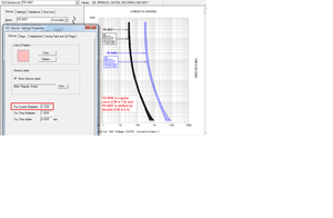

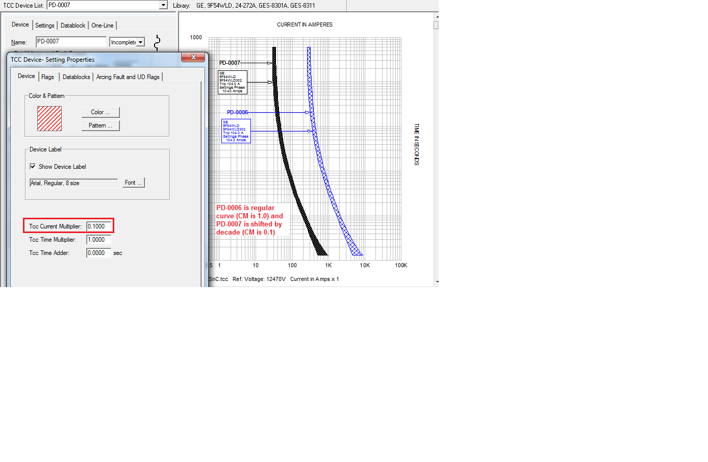

Did you get this this issue resolved?
Looks like the TCC multiplier is set to 0.1 instead of 1.0, hence the curves are to left by a decade.
I think you're right. Duh!
I changed reference voltage from 12,470 to 480V (which I know shifts the curves) then changed back to 12,470. The current scale still says 1x but the multiplier went to .1 instead of 1 for some reason. I tried this on other models and duplicated it. Something I'll have to look out for in the future.
Thanks!

I too think they are light for a 1500 kva transformer. They don't coordinate with the transformer in-rush or the secondary side MDP main fuses. I don;t have a practical way to check these to see if that is what is really installed.
