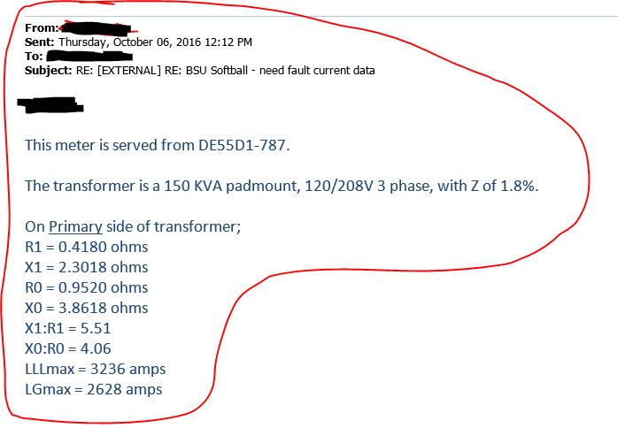

I feel for you. Not to rub salt in the wound, well maybe a little. I feel fortunate. Here is an email from our utility when I asked for the same info as you on a facility that is not connect to our campus distribution system but is just a bit off campus that I modeled a couple years ago. They've also sent me screen shots of their models including trip curves before without any resistance to the request at all. Of course, it may have something to do with the fact our peak demand each month is generally well over 20 megs and our bill is in the millions annually. We're a pretty large customer for them so they treat us pretty well. Attachment:

mayanees
Post subject: Re: Utility refusal to provide service transformer impedance Posted: Thu Jan 04, 2018 1:12 pm |
Joined: Tue Feb 17, 2009 8:38 am Posts: 62 Location: Westminster, MD
bbaumer wrote: I feel for you. Not to rub salt in the wound, well maybe a little. I feel fortunate. Here is an email from our utility when I asked for the same info as you on a facility that is not connect to our campus distribution system but is just a bit off campus that I modeled a couple years ago. They've also sent me screen shots of their models including trip curves before without any resistance to the request at all. Of course, it may have something to do with the fact our peak demand each month is generally well over 20 megs and our bill is in the millions annually. We're a pretty large customer for them so they treat us pretty well. Attachment: Utility Example.JPG ... well thanks for that  I must clarify though that I've never had this level of ignorance from a Utility, and we've done hundreds of Studies over the past 5 years. The Utility in this case reiterated their position with the following: Since our last correspondence, my management and other individuals involved had a meeting to address the issue of providing nameplate impedance to consultants for "Util name removed" customers. We came to the conclusion that we needed direction from our standards, safety, and legal departments before providing this information. We are concerned that using the nameplate impedance is not a safe practice for our customers. I personally believe this is an unsafe method of determining the worst case incident energy level over the four year period of review. As I noted before, a change in the distribution transformer can easily put the PPE requirements into a higher level of protection. Until we get direction from these groups, we won’t be providing nameplate data on distribution transformers. So yes, I am in pain, but a little salt's good every now and then

Quote: it is not a simple process to retrieve nameplate data. I find that statement hilarious. How hard is it to go to a padmount txf, unlock the padlock, use the pentagon wrench and open the low side door? And it is not PPE restrictive as NESC lists a 4 cal/cm2 incident energy for that task and I am sure their linemen or substation electricians open padmount doors frequently. But seriously, I do understand/feel your pain! Keep plugging at them!
