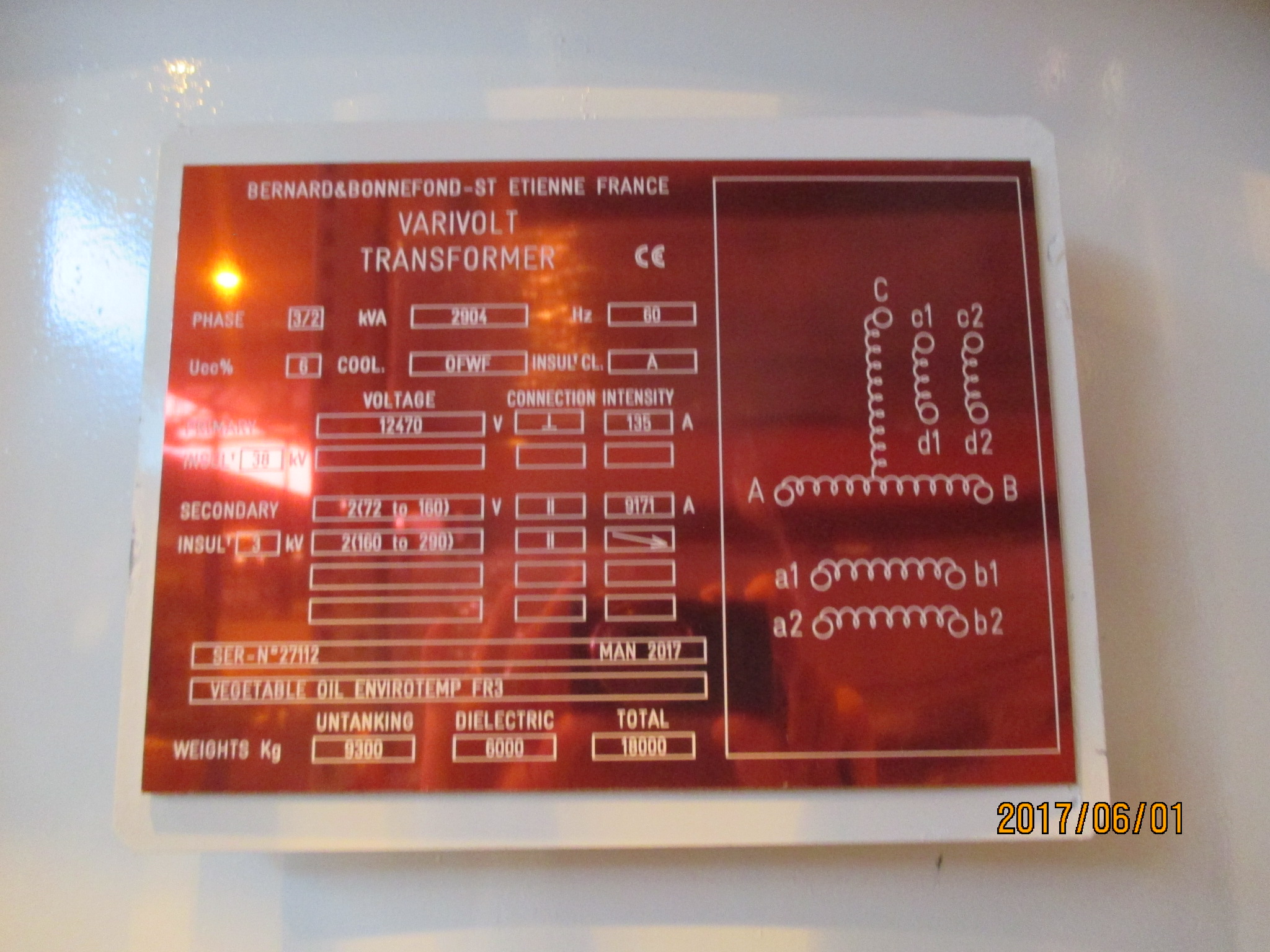

Does anyone have suggestions for arc-flash hazard labeling of equipment on the secondary side of a Scott connected transformer? The transformer is a "Varivolt" design and the secondary windings deliver a voltage between 72 and 290V. My understanding is that the IEEE 1584 equations apply to three phase systems. SKM does not model Scott connected transformers. Any ideas?

Scott T-Connected transformer, 3 phase primary, 2 phase secondary. The transformer has a rotating winding with sliding contacts that act as a tap changer.

... just curious, is your Scott T secondary powering direct immersion electrodes for glass furnace? ... use of such a varivolt Scott T secondary is the only method I am familiar with ...
 Post subject: Re: Scott Connected Transformer
PostPosted: Wed May 23, 2018 6:40 pm
Joined: Fri May 18, 2018 6:05 am
Yes, that is the application.
