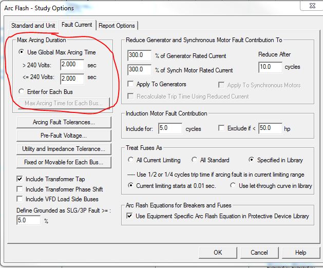

When you have a Wye/Wye bank of 3 transformers each with a different impedance which impedance do you use for the purpose of the arc flash model? In my case I have impedances of 6.49, 6.61, and 6.53. Do you use an average which would be 6.54 or do I use the lowest value of 6.49?

It is an older transformer...not far away from being replaced. It is set to it's lowest possible tap setting of 12.54 kV for the primary but is being supplied with 12.47 kV. I do have nameplates for each can identifying the impedance's as I listed them. There is a couple calorie difference on my low voltage switchgear when I model using the lowest imp versus modeling the average imp. Not a major deal since both are around 200 cal/cm2. I'm just really curious what is the correct method.

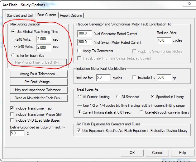

Sorry I can't help you but 200?
Are you using the "2 second rule" and still that high?
Yes, 200.3 cal/cm2 to be exact and with the 2 second rule. These values are seen at the low-voltage switchgear which is directly connected to the secondary of the transformer. Luckily, in this case we just replaced the switchgear and all buckets have ARMS. With ARMS activated I can get the IE down to 4 cal/cm2 for all feeder buckets.

Are you including the utility fusing on the primary side of the pole mount cluster? Or are you just letting it run to 2 secs? utililizing the utility fuses may make a big difference.
We are letting it run for the full 2 seconds. Another firm completed the arc flash and did not investigate to determine what fusing is being used on the primary side. I now have plans in place with the customer to investigate the primary fusing when they are being accessed for other reasons so that we can get them added to the model.
