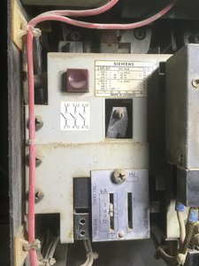

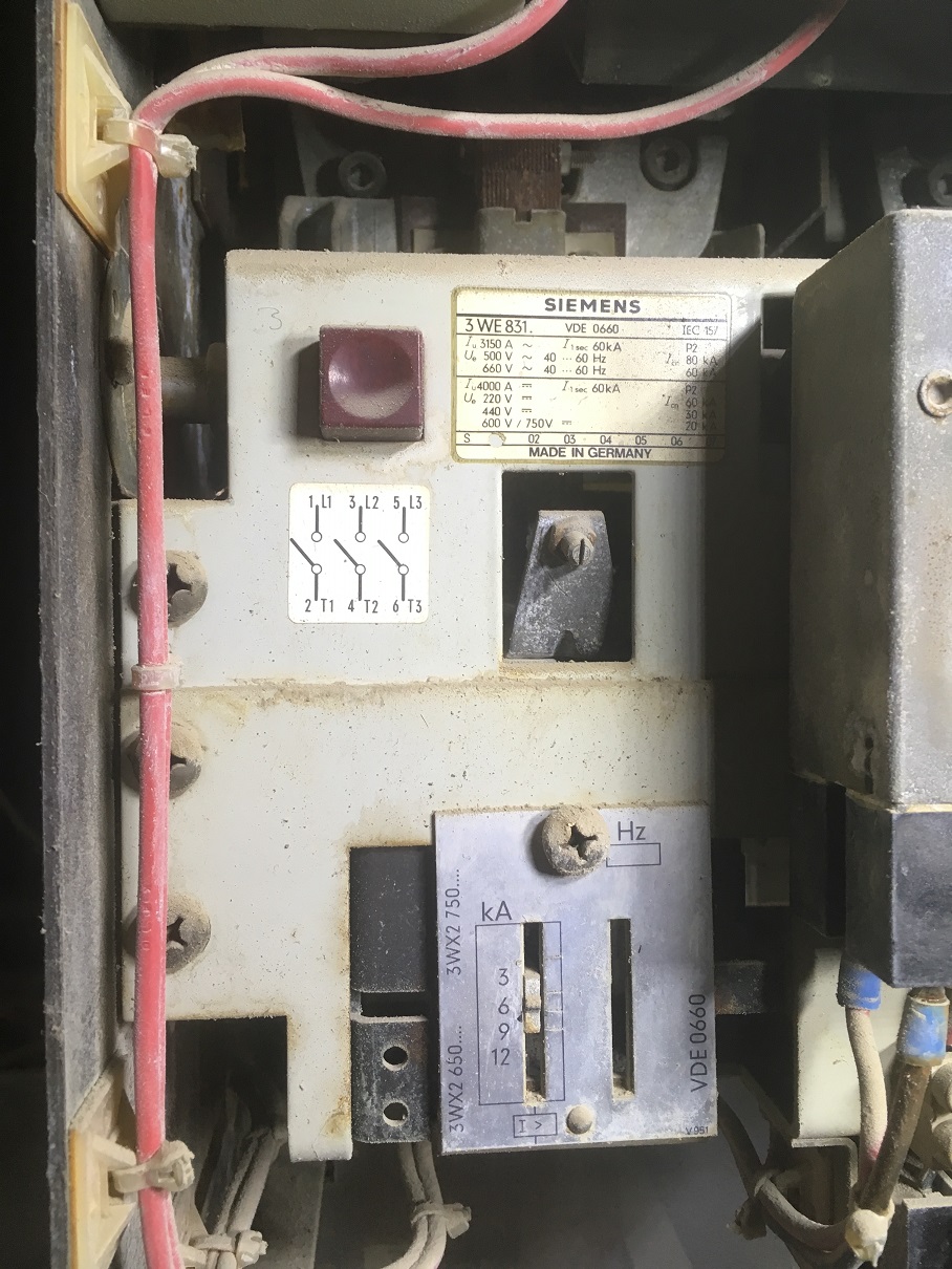

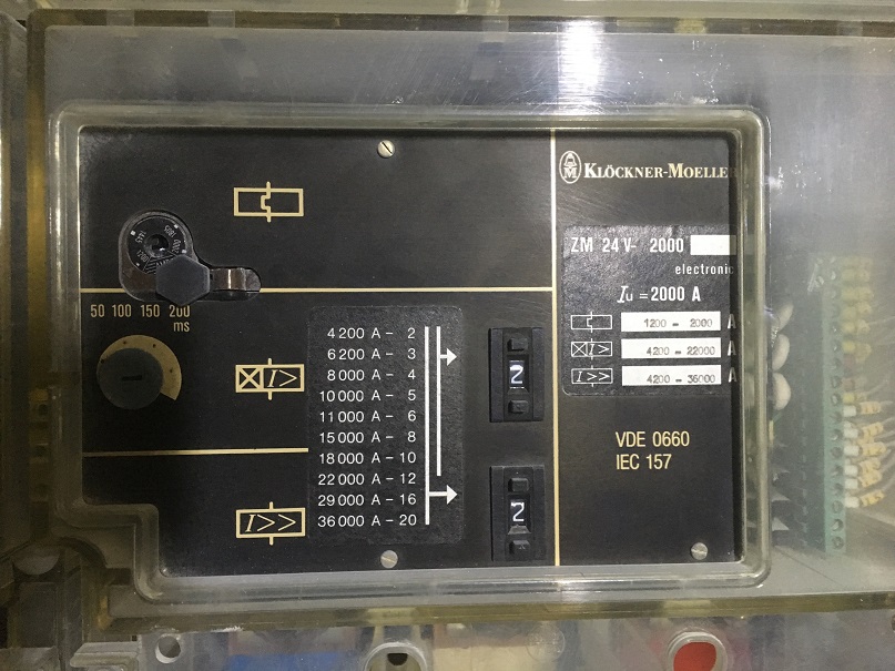

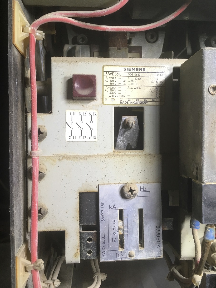

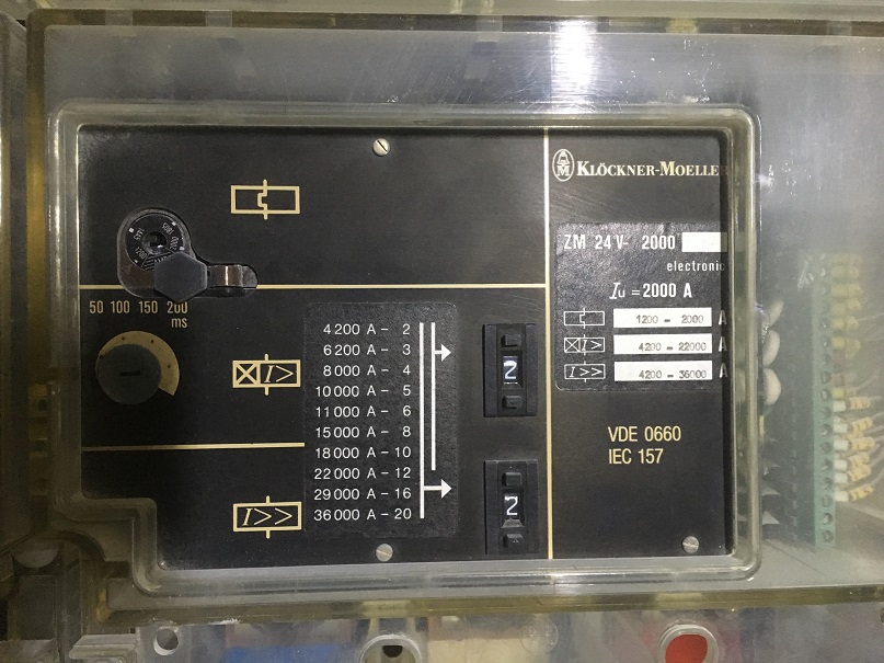

Hi Guys, I am trying to get manufacturers data (TCC's and protection settings) for the following breakers but not having any luck. Can anyone help with data sheets for the following.
Klockner Moeller
Breaker NZM 24 - 2000 with ZM 24V-2000 electronic protection
Breaker NZM 24 - 2000 with ZM 26V-4000 electronic protection and ZM 36V-3000 electronic protection
Siemens
3WX2250-0..00
3WE 831 with 3WX2650
Images are attached also
Many thanks

for the Kloeckner Moeller (which is now Eaton) CBs you can use an Excel-Tool from Eaton:
http://www.eaton.uk.com/EatonUK/Product ... CT_1559576
They have a legacy page that includes this particular breaker. After you input all trip settings, it shows you the respective curves.
