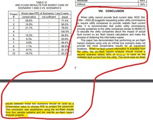

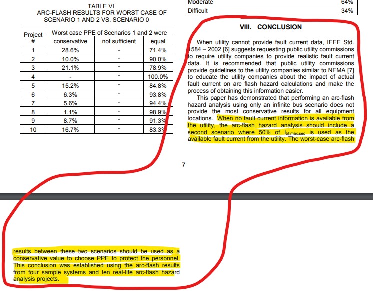

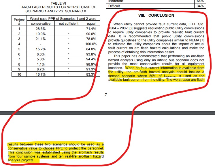

Conclusion: Run an infinite bus scenario and a 50% scenario. This is indeed better than infinite bus alone but probably not as conservative as running more scenarios than just infinite and 50%:
