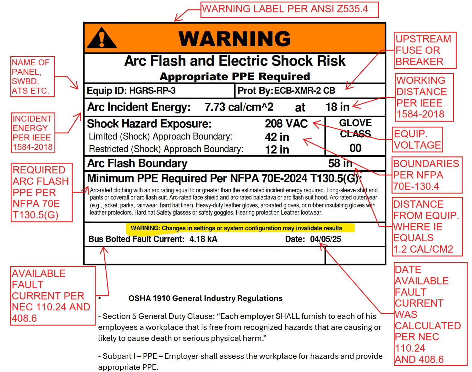

I have one long-time customer that only wants his equipment labeled and if I find any over-dutied equipment or signs of something in disrepair during data collection. If and when I find an issue in one of his buildings, he addresses it immediately. He doesn't care about reports at all and doesn't want to spend the time and money for me to create reports that he won't ever read or use. If he has to change something in the distribution system he just calls me to make the change to the model and provide a new label or labels if needed.
I bring this up because I gave another customer the same option yesterday to save time and money. They questioned how someone could possibly do without a report. After some discussion and without getting too deep into it, it was clear they did not have a good understanding of the data typically included in a report and what is not included and what may or may not need to happen if they were to make say, a breaker setting change or a fuse size or characteristic change. I find that this is pretty typical.
A small minority of customers of mine have EE's on staff, or other highly electrically technical people that completely understand what is in a report and look at it closely, but I find that most others do not and don't really care. They do not look at arc flash reports, trip curves, fault contribution tables etc. and wouldn't know what they were looking at if they did. They just want their equipment labeled and staff trained on safety and how to read and use the labels, and, much like my other customer, to know if there are any problems identified they need to address.
What is your experience and how do you feel about not issuing a study report for customers that just want the labels and to know if you find problems? Do you see any risk involved for the engineer by NOT issuing a report if the customer doesn't want to pay for something they will never look at anyway? In some ways I think by not issuing a report, it actually lowers your risk and the customer's as you are not giving the customer a tool they do not know how to use properly and could misinterpret and misapply. It forces them to reach out to a qualified person if they want to make changes to their system instead of trying to interpret a trip curve. Most people have a warning about making changes on the label like is highlighted in the example below. Do you agree or disagree?
