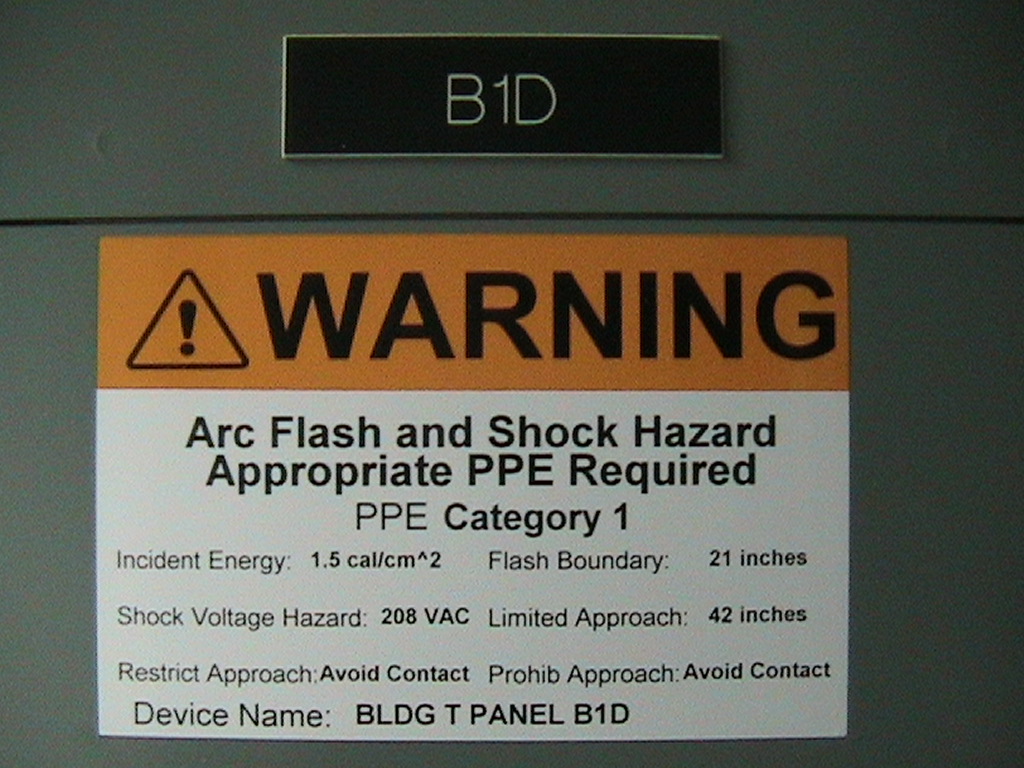

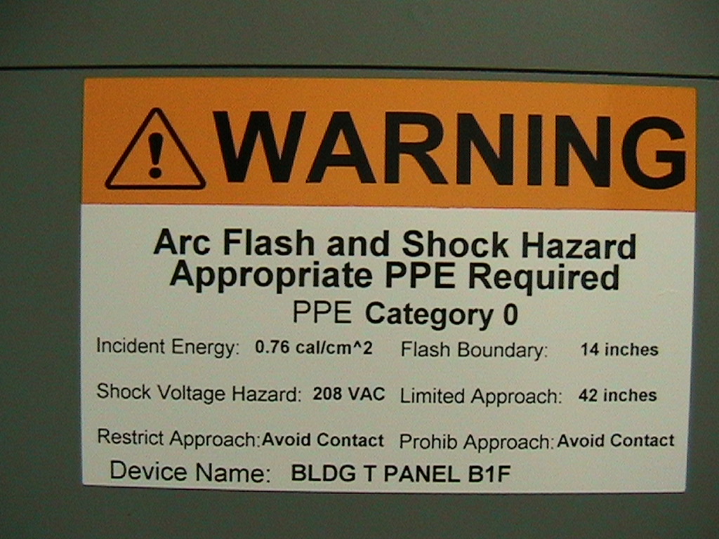

Hi All,
I was hoping one of you might be able to help me reconcile some 70E articles. Article 130.7(C)(1) states "When an employee is working within the arc flash boundary......All parts of the body inside the arc flash boundary shall be protected." 130.7(C)(7)(b) goes on to say "Hand and arm protection shall be worn where there is possible exposure to an arc flash burn". 130.5(B)(1) states "The arc flash boundary shall be the distance at which the incident energy equals 5J/cm2 (1.2 cal/cm2)." Labels still in place at many sites appear to only call out for arc-rated FR if the incident energy level equals or exceeds the 1.2 cals at the chest and if less called for the cat 0 non arc rated protection. See the following labels.
Assuming that if the incident energy at the chest was less than but close to the 1.2 cals it would seem likely that the forearms would easily exceed the 1.2 cal value. Informational Annex H3 states that for cal ratings >1.2 cals Arc Rated garments are needed. Finally 130.5(C)(1) states "Recognizing that incident energy increases as the distance from the arc flash decreases, additional PPE shall be used for any parts of the body that are closer than the distance at which the incident energy was determined."
How should I relate to all this? Assuming that the workers hands are within the 12" restricted approach boundary requiring insulated gloves with the leather protectors the only part of the hand arm that might be at risk of burn would be the forearms. Does the 70E standard by the articles sited then require an FR shirt so the arms are protected assuming the incident energy is greater than 1.2 cals?

Hi Paul and thank you as always for your thoughtful thought out response. What I gleaned from it was that as I had suspected the arms are at risk of experiencing incident energy at levels above the 1.2 cal limit even though the IE at the working distance is less than the 1.2 cal level. There was one more 70E article that I should have sited in my first post, article 130.7(C)(6), it says "Employees shall wear arc-rated clothing wherever there is possible exposure to an electric arc flash above the threshold incident energy level for a second degree burn......1.2cal/cm2." With this in mind if someone were to attempt to follow 70E to the letter than wouldn't they have to do an incident energy calculation at the distance from the arc source where the rubber insulated glove with its leather protector ends? This is even making an exception for the gloves in that they are not arc rated. If this study showed the arms to be above the 1.2 cal limit than wouldn't arc rated FR be required per the standard? I feel sometimes like I am taking these quest for understanding to the point of absurdity but as someone who does training I know at some point in time the question will be asked and I like to feel somewhat prepared to answer. If I am reading the standard and interpreting your comments correctly many of these pieces of equipment with the older labels indicating an HRC cat. of "0" or newer installations where the labels indicated no arc rated FR needed are probably not in compliance with 70E, at least its' article 130.7(C)(6).
