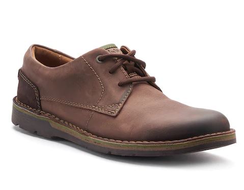

To me, this is an example of where common sense should prevail.
Leather footwear:

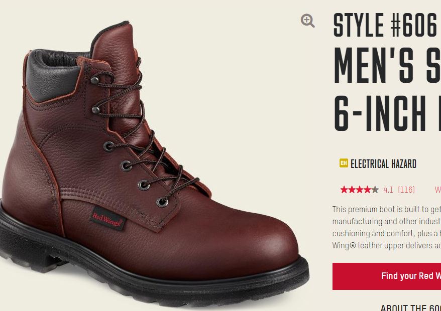

Heavy-duty leather footwear:
Finally, I think NFPA 70E is discriminatory against vegans and offensive by specifically stating footwear must be made of leather. :)

I think bbaumer's photographic definition is correct. The shoe industry generally defines heavy-duty to mean work boots. I would argue in our industry we would want that term to also include EH rated and I could make the argument that 6" minimum height should also be considered (as does my company as part of our corporate PPE guidelines).
As for the Vegan issue, I would have to imagine any shoe that can meet an 8cal rating should be fine as per the leather requirement, as the above reference shoes the code implication that the leather is chosen to meet that cal level.

Any concern over the vinyl collar at the top of that unrated work boot above? Very close to the skin when worn.
