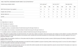

We need ARCPRO to comply with OSHA 1910.269 table 3 for calculations above 15kV....but that is difficult without the software being made available to customers willing to buy it.

The issue becomes if you are trying to meet OSHA 1910.269 for making a reasonable assessment of incident energy for electric utilities. OSHA provides a table in Appendix E which lists what OSHA considers as methods which provide reasonable estimates of IE and the only method listed for >15kV is ArcPro. OSHA would probably accept another method, such as ARCMASTER, if there is documentation showing the two methods are comparable. So, IMHO one might as well use ArcPro and save a headache of trying to prove to OSHA the other method is equivalent.

Thank you for all your comments regarding other software options, but OSHA will only accept ARCPRO over 15kV as per Table 3 in the first post of this thread.
I have used ETAP for the rest of the facility with no issues. I also used ETAP for the calculation above 15kV (Ralph Lee Theoretical Calculations), but according to OSHA Table 3 this is overly conservative and is not acceptable. See note 3 of Table 3.
