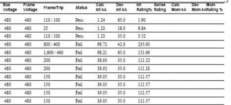

See the attached pic.
What PPE CAT and IE level should I label the 208/120 Panel?
PostPosted: Thu Nov 05, 2009 10:24 am
Well, what the study says, HRC 3. However, I would question these results, do you know all the info used for the calulation?

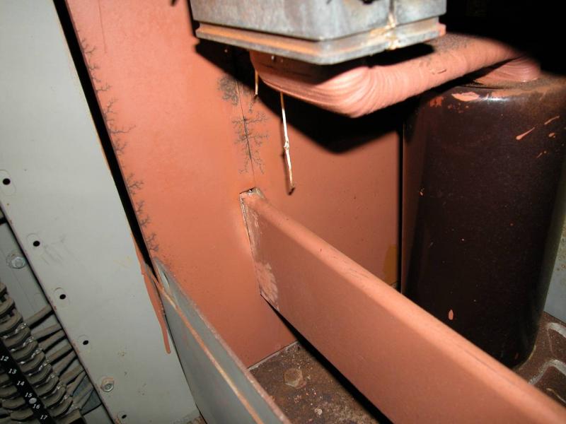

I like the label.. Looks like this is generated from easypower? Do you do a study on all your transformers <125KVA? why 2* rather than 3? Did easy power calc this?

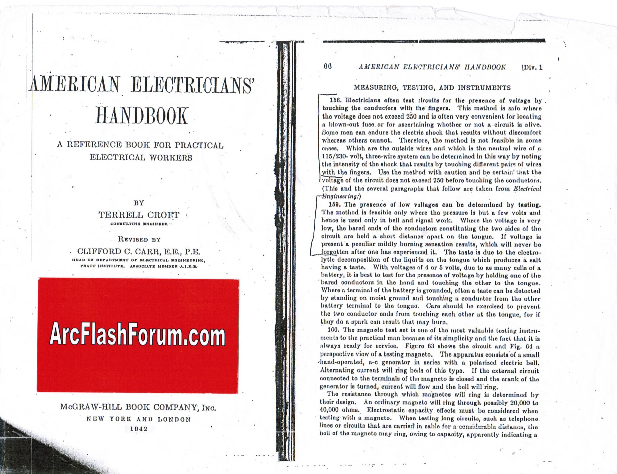

Low Arc Flash Hazards
The attached file is what I use for all panels/enclosures fed by single source transformers < 125kVA, V<=240. We label for uniformity and clarity.
