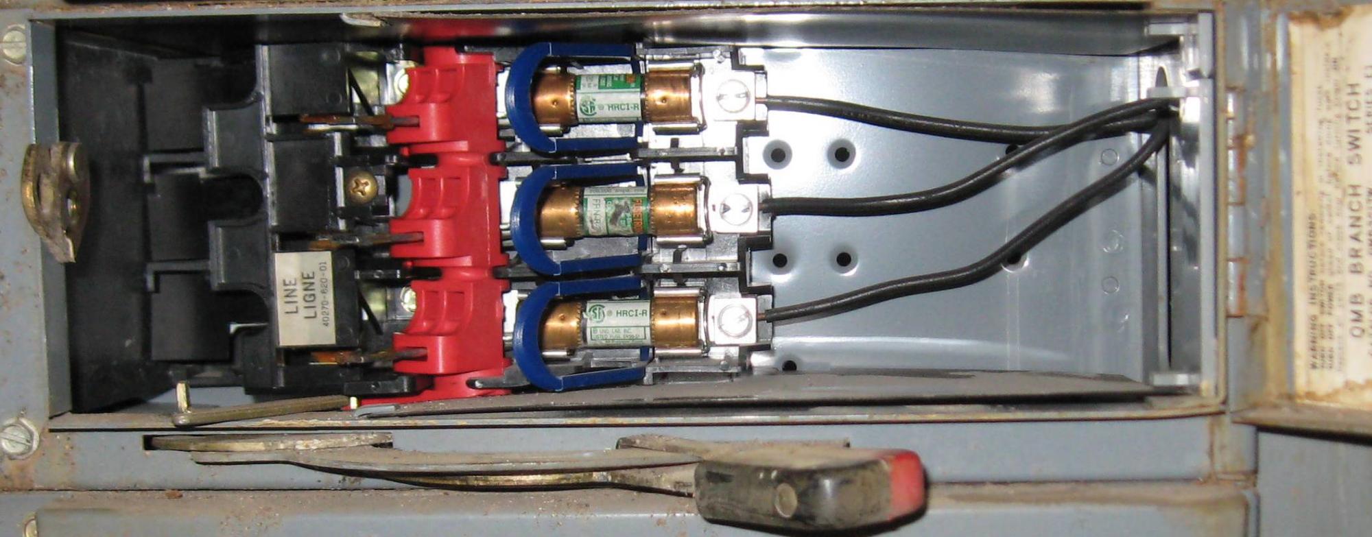

Good day,
To update the group, we recently tested foam lined hard cap's (CSA Type II) at Kinectrics. We were responding to ignition questions within the industry. The two caps we tested (as per attached) provided encouraging results.
We presented the test results to the CSA Z462 TC at our last meeting in Calgary a few months ago.
Hope this helps!

Thanks Jim, good stuff.

Great Job Jim! You all keep up the good work.

I wanted to clarify for the group that some foam lined hard caps can ignite, this is not a myth. The most important part to selecting the proper hard cap is to conduct a thorough hazard analysis. As an example, if the incident energy exposure is above 12 cal/cm2 then a hood should be selected. Hoods which fully encapsulate the hard cap (bee keeper type hood) should make foam liner ignition a moot point.

Jim has there been any further testings to these particular hard hats?

Isn't this equivalent to wearing synthetic meltable underwear under FR, and therefore disallowed?

I agree with Stevenal. I do not believe that you should have anything under your FR PPE that would have the possibility of melting. It is not allowed for clothing so it shouldn't be allowed accessories.
